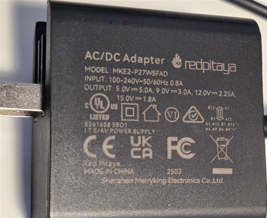

Voltage distribution might follow the pinout pattern shown on the adapter. This is my first experience with a USB-C power adapter like this. I’ve put a warning sticker on it, so it doesn’t get used elsewhere. I would assume it would work as a USB-C 5VDC power supply, but I am not sure. Also, I hate to have to replace the supply because the magic smoke was released or if the power supply itself got misplaced. The power supply is staying with the unit, for safekeeping.

  • USB-PD confuses a lot of people that come from the world of barrel connector oriented power.
    "What do you mean that it's slow charging? it's a 100w fast charger!"
    "Wait, it doesn't have the 15v 3a USB-PD profile that the device requires for 45w, instead it has 20v 2.25a and because it can't negotiate or handle that it's now charging at 22w?!"
    Cue much confusion, and sometimes, electronics damage.

  • The pinout is the same for each voltage. The consuming device negotiates the voltage with the "USB charger".
    The protocol is called USB Power Delivery (USB PD).
  • Can I assume there is a industry standard pinout for each voltage on the USB-C connector. Only ever used them for 5VDC. Pushing my horizon.
  • Oh dear... "The power supply sports a USB-C connector. Reading the label, you discover it outputs 5VDC, 9VDC, & 12VDC. That surprised me."
    Many mobile phone chargers apply this design approach. It has been mentioned before and described in detail in a few Element14 blogs.
