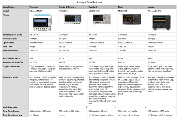

There is a surprising amount of 1 GHz bandwidth oscilloscopes out on the market, so when picking some comparisons for the 3 Series MDO, I went for oscilloscopes carrying a similar price tag to the roadtest unit. All of these oscilloscopes come with an array of options for the package, that make pricing more subjective, the price I have provided is for a basic 1 GHz bandwidth oscilloscope without any of the options.
General Characteristics
The 3 Series MDO seems to come out middle of the range of the few I have selected. It is slightly more expensive that the RTM3004, but dose offer that slightly larger screen, but that is negated by the Wavesurfer 510, that offer a larger screen than the 3 Series for even less money than the RTM3004, but it comes in at twice the weight.
Analogue Specifications
Analogue wise the 3 Series MDO is at the smaller end in the memory depth department and in comparison its waveform update rate is quite a bit lower, except when compared to the RTM3004. It has 8 bit vertical resolution as per all the others, apart from the RTM3004, that has 10 bit. Maths and trigger functionality is fairly similar, except that the 3 Series MDO can only display 1 math channel.
The time base accuracy specified seems to be quite a bit worse than the other oscilloscopes in the table.

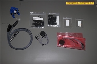

I have covered these in detail within Blog 1. In brief, the unit supplied for the roadtest suffered from intermittent operation, but did seem to overcome the issues over a couple of days. Looking around the unit in detail, revealed some damaged screw heads and incorrectly fastened screws on the rear grill. A review of the package supplied, showed that the connecting lead between the digital inputs and the two channel leads was missing along with a probe tip for one of the passive probes.
With these issues, Tektronix requested the unit back to them and provided one of their demonstration units for me to carry on the roadtest with. In some ways I was against this as to me, the build quality and performance is all part of the roadtest, however, the advantage was that the demonstration unit came with one of their signal demonstration boards, which is very nice for looking at the various functionality of the oscilloscope.
The same quality issues were not present with the demonstration unit, it does have a few knocks and scrapes, but this is to be expected. Out of curiosity I checked over the probe contents that arrived with the demonstration unit.
Compared to the roadtest unit, there was a mixture of extra and missing bits. Missing was the accessories with the colour identification bands, only one passive probe has its colour band, and the earth adapter lead for use with the micro-grabbers, the extra long earth lead was within one of the passive probe kits. Somehow, there seems to be an extra package of 10 micro-grabbers and hook tip with probe shroud. In reality, probably typical for a demonstration unit, although it does ask if someone has checked and replenished the kit before sending it out?
The part of the digital leads missing from the roadtest unit can be seen under neath the element14 blue man in the picture above, without it, the digital leads cannot be connected to the oscilloscope.

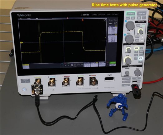

I have a small fast pulse generator from Leo Bodnar Electronics with a nominal 40 ps rise time output. Actual measurements for my unit are 35.68 ps rise time and 31.53 seconds fall time. Should be fast enough. Looking through the specifications for the oscilloscope, I can find a calculated rise time of 400 ps with the channel set to 100 mV/Div and 50 Ohm input impedance. I therefore set up the pulse generator to give a 400 mV peak to peak output and connected up to the oscilloscope.
The pulse generators quite compact and whilst plugging it directly into the channel input of the oscilloscope is possible, it is made a little awkward due to the recessed nature of the channel inputs. I found myself handling the pulse generator board a lot more and pushing on the BNC mounting area of the PCB.
The specification from the manufacturer does not give the ratio for the rise time measurement, by default it is set to 10/90 %, so I took a set of readings at this ratio and then repeated for a 20/80 % ratio. Naturally, I forgot to set the channels to 50 Ohm input impedance, so had to repeat everything anyway. To aid with measurements, the statistics can be displayed on the measurement screen, or can be moved to the measurement bar at the side to allow the full screen to be used. This suggests why the measurement bar is limited to 4 different measurements as enabling the statistics takes up more room.

The measurements were reasonably consistent across the channels, however neither the 10/90 or 20/80 ratio were found to be that close to the calculated specification. This may be something to do with my test methodology as it is not something that I am particularly experienced in carrying out.

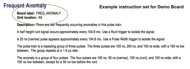

The demonstration package arrives with the Tektronix MDO Demo Board 1 that generates a variety of signals for capturing on the oscilloscope. I believe that the board can be purchased, I have seen a couple on eBay for around the £300 mark. I have no idea what it costs brand new.
A brief set of instructions is included with the board that gives a layout and instruction set for each signal that defines the location of the signal on the board, circled in the screenshot below. This makes setting up and taking measurements a bit easier.
The board requires dual USB ports to provide power to it and can be powered directly from the oscilloscope with the lead supplied with the board. The majority of the time I powered the board from a mains to USB adapter to free up the front USB ports to save data to a USB stick.
The board does appear to be made primarily for the MDO 4000 series of scopes and contains signals that the 3 Series MDO does not have built in acquisition modes for. The 3 Series MDO however, does include the demonstration functions within the utility menu of the oscilloscope, so can be set to capture some of them automatically, the others require manual setup of the oscilloscope. The screenshot from the oscilloscope below shows the signal demos available on the 3 Series MDO.

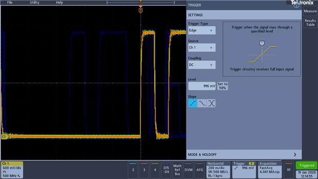

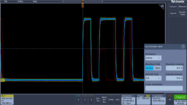

One signal of interest to me is the fast acquisition function demonstration. This is viewed on the Rare Anomaly signal and set by the Fast Acq demonstration.
The setup for this turns on screen persistence and you can just about see the rare signals building up on the screen as the blue tracer behind the main set of three pulses of the overall signal.

The FastAcq has four palettes available to help distinguish the signals. Personally I found that the Spectral Palette offered a slightly better representation of the signal. The Inverted Palette starts out okay, but can become very busy for this particular signal if left for too long.
{gallery} Fast Acquisition Palette Options
Palette Options available fro Fast Acquisition
Spectral Palette Option for Fast Acquisition
Inverted Palette Option for Fast Acquisition
Other than enabling the Fast Acquisition mode, none of the other settings of the oscilloscope are that specialised. I did find out investigating this signal, that the volts / div can actually be set to any preferred value within the overall range by entering it into the scale box. The demonstration setup sets this to 600 mV/Div, which is not one of the default range values that are selected by the rotary switch. However, double tapping on the vertical scale box, provides a keypad to enter any desired value, as shown below.
As can be seen from the screen captures above, the rare anomaly signal has a half size pulse and a narrow pulse embedded within the signal and the 3 Series MDO offers runt and pulse width triggers to help isolate these. I looked at the runt trigger first.
{gallery} Runt Trigger Demonstration
Signal captured with Runt Trigger
Runt Trigger Options Available
Runt Trigger Settings Used
Automatic Pulse Width Measurement of Initial Pulse
Setting up the width pulse measurement between cursors
Runt Pulse Width Measurement
To get the runt trigger to function, fast acquisition mode and screen persistence are turned off. The runt trigger has a number of options, I found that most stable one to use on this occasion was the 'runt occurs' option, which allows lower and upper threshold values to be set. The lower threshold is set below the runt pulse amplitude and the upper above, so that the pulse crosses the lower threshold value and not the upper.
The instruction sheet gives the width of the runt pulse as 100 ns, that I tried to measure with the measurement function. Initially, the measurement function is set to find the first pulse on the screen and as the runt pulse is the third with the train, its width is not measured. The initial pulse was measured as 49.93 ns, which matches the instruction sheet value of 50 ns.
The only way I could get the automatic measurement of the width of the runt pulse was to set the measurement to occur between cursors. The width was then measured as 74.90 ns, which is quite a bit lower than the specified 100 ns. Of course, there is always the option to utilise the cursors to make the measurement of the pulse width.

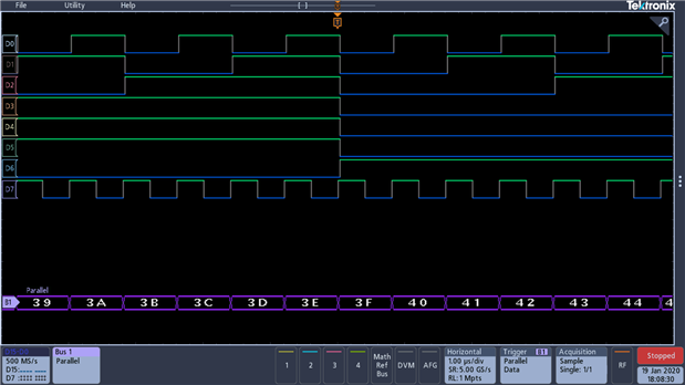

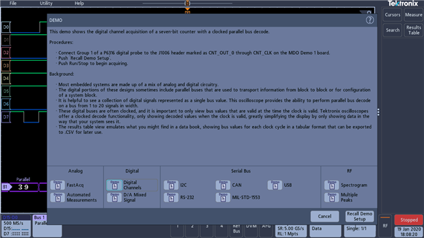

There are two main demonstrations for the digital inputs, one being monitoring of a counter and the other a mixed signal covering the inputs to a DAC and output from it.
{gallery} 7 Bit Counter Monitoring Demonstration
Digital input demonstration description
Digital input demonstration screen

This is the first time I have used a mixed signal oscilloscope and it is surprising the amount of information that it is capable of recording and the ease of displaying a number of signals that interact with one another. Set up is obviously easy using the demonstration facility, the DAC was reasonably easy to understand, the concepts behind the parallel decoding were not so obvious to me.

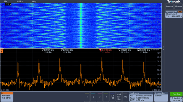

RF Demonstration
The demo board has some RF signals built into it for testing the spectrum analyser out with. The majority of these seem to centre around a 2.4 GHz signal.
One program demonstrates the multiple peak find capability of the 3 Series MDO.
{gallery} Multiple Peak Setup
RF Vertical Channel Settings
RF Vertical Channel Options
Time base settings
The demonstration outputs 11 peaks for the analyser to find, which is the maximum number of peaks for the 3 Series.
Out of curiosity, I wondered how close the auto set function would get to the pre-programmed setup. As seen below, it does not find as many of the peaks as the specific set up does. Both the bandwidth and span settings are about half of the pre-programmed setup. It has also set a slightly different reference level.
The number of peaks and threshold can be adjusted to suit the signal being analysed. A spectrogram is available to record signals that show more variable activity, it takes 60 to 70 seconds for the spectrogram to fill its screen, once stopped the spectrogram can then be analysed by stepping through each slice using the oscilloscope controls.
{gallery} Spectrogram analysis
Spectrogram screen
Slice 80 of the Spectrogram at 12.2 seconds
Slice 195 of the Spectrogram at 29.6 seconds
The signal provided on the demo board for the Spectrogram is a rolling version of the multiple peaks waveform. There is also a frequency hop test signal that I found quite good to look at with the Spectrogram. The following video shows some of the spectrum analyser operation, signal measurements and spectrogram use which some may prefer over looking at the screenshots.
