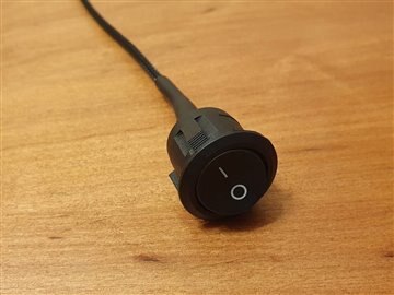

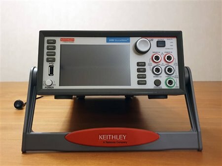

At first sight instrument looked physically well designed. It comes with front and back bumpers that allow easy "Lego-like" stacking of multiple instruments, but can also be mounted on a rack if needed (the instrument is half-rack 2U high). The display is matte and has a decent viewing angle and brightness.
When the instrument is in output-on state, the switch illuminates very bright, serving in this way as a good warning sign (as the instrument can seriously injure the user if not manipulated with care). Rubber buttons with text on them are back-lit, making them easy to find in low light conditions. The instrument uses status lights to indicate the status of the the front/back connection, remote control, LAN, IEEE 1588 and Interlock (It is worth noting that the 1588 functionality is not supported at the time of writing).

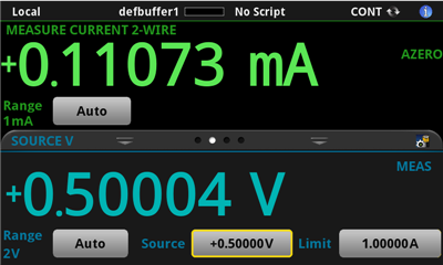

The home screen shows at the top what is being measured and at the bottom what is being sourced. What is being sourced and measured can be changed by pressing the FUNCTION physical button.

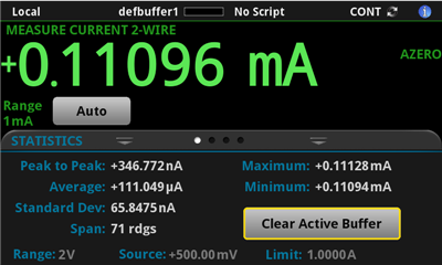

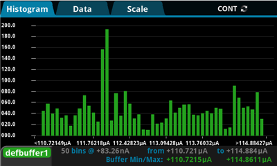

The instrument can display the statistics, the table, the histogram and the graph of the data to quickly explore it.
