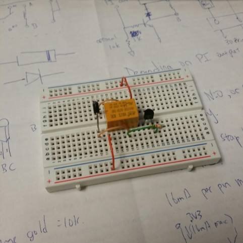

I tested this relay board out on a breadboard. seems to work well. I had to move some components around to scale it down to the size board i had laying around. This is for a remote switch for the 3d printer i got. I'm going to connect it to the gpio pints of the raspberry pi/ octoprint server to shut it down remotely.
I'll test it out on a something else like a light before the printer to ensure i don't fry it. Fingers x'd.

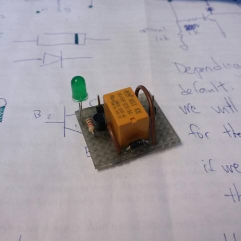

    I finally got this thing up and running and it works great turning the printer on and off. After the breadboard prototype, i had to move stuff around and went a lil' off track from the original design…

    rctho over 8 years ago
    I finally got this thing up and running and it works great turning the printer on and off. After the breadboard prototype, i had to move stuff around and went a lil' off track from the original design that set me back a bit but i finally got it to work. Octoprint has a PSU plugin that saved me from having to edit any config files. I just setup the reset function in the plugin settings by adding the gpio pin to trigger the relay board and thats it.
    Off to a good start finishing up some old projects. Time for some remote printing. I want to print a case but i only want to have one power cord to power everything. Power and ethernet coming in and printer and camera going out. Maybe a power switch too. Any suggestions?
    mcb1 over 8 years ago in reply to rctho
    The voltage is 12 with 7 amps
    In that case you should be fine.
    You'll need to add some wire onto the pcb traces.
    If it's using a supply from a computer, they often fool it by bridging out the enable wire.
    You might be able to interupt that instead.
  • Robert Peter Oakes
    Robert Peter Oakes over 8 years ago in reply to rctho
    Correct, you can get it to work but it is much easier to keep the power side separate from the PI, the PI wants 5V, nice and clean, the relays and the LED loads want probably 12V and it will have quite a bit of noise when switching so if you want to avoid hard to diagnose issues, keep them separate except for a common ground
