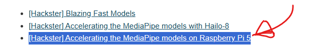

  • [Hackster] Blazing Fast Models

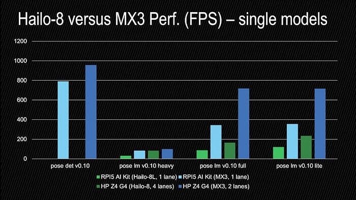

  • [Hackster] Accelerating the MediaPipe models with Hailo-8
  • [Hackster] Accelerating the MediaPipe models on Raspberry Pi 5

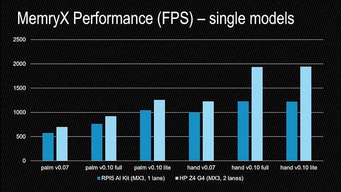

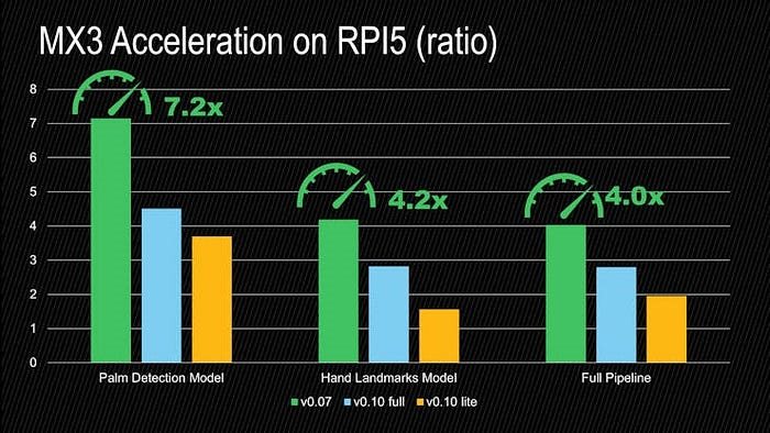

Finally, I will perform profiling to determine if our goal of acceleration was achieved.
TLDR :)
In summary, the user experience with the MemryX solution has been absolutely wonderful:
  • The technical support is world class, at a level I have never seen before
  • The on-line documentation and provided examples have been very clear and useful
Thanks to MemryX’s use of floating-point (BF16) in the feature maps, there is no need for quantization, which leads to several additional advantages:
  • There is no need for calibration data, since quantization is not required
  • There is no need for a GPU, since quantization is not required

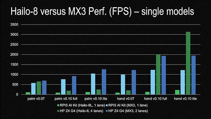

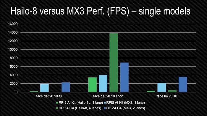

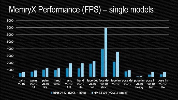

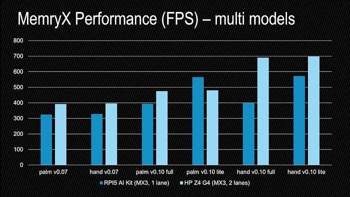

When compared to other AI flows, MemryX finished the crossing line in first place for the following reasons:
  • Successfully compiled all the mediapipe models I threw at it
  • Best performance overall for these mediapipe models

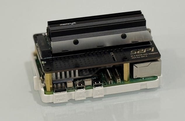

MemryX Flow Overview
MemryX’s Software Suite allows users to deploy models to the MemoryXAccelerators (MXA), specifically their PCIe Gen 3.0 compatible M.2 AI accelerator modules:
MemryX AI Acceleration Offering (Camera: AlbertaBeef)

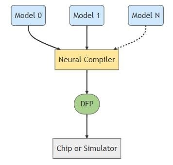

The deployment is handled by the Neural Compiler and involves the following tasks:
  • Framework I/F
  • Graph Processing
  • Mapper
  • Assembler
MemryX Neural Compiler (Camera: MemryX)
The FrameworkI/F task translates models from industry-standard frameworks to an internal graph representation.
The Graph Processing task performs model optimizations (layer fusing, layer splitting, breaking complex layers into simpler ones, activation layer conversion) for execution on the MXA hardware.

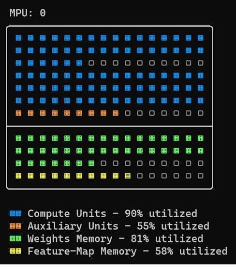

The Mapper task allocates resources to the available MXA devices.
MemryX Neural Compiler — Mapping Visualization (Camera: MemryX)
The Assember task converts the mapped model to micro-code as a single DFP file, that can be run on the MemryX MX3 acceleration module.

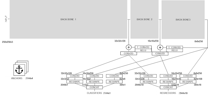

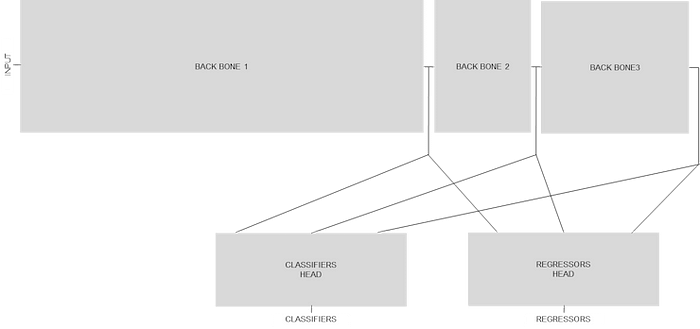

A Deeper Dive into the Palm Detection model
Before we tackle the deployment flow with the MemryX SDK, it is worth taking a deeper dive into the models we will be working with. For this purpose, I will highlight the architecture of the palm detection model.
At a very high level, there are three convolutional neural network backbones that are used to extract features at three different scales. The outputs of these three backbones are combined together to feed two different heads : classifiers (containing score) and regressors (containing bounding box and additional keypoints).
Palm Detection — Block Diagram 1 (Camera: AlbertaBeef)
The input to this model is a 256x256 RGB image, while the outputs of the model are 2944 candidate results, each containing:
  • score
  • bounding box (normalized to pre-determined anchor boxes)
  • keypoints (7 keypoints for palm detector)
Palm Detection (0.07) — Block Diagram 2 (Camera: AlbertaBeef)
The following block diagram illustrates details of the layers for the model. I have grouped together repeating patterns as “BLAZE BLOCK A”, “BLAZE BLOCK B”, and “BLAZE BLOCK C”, showing the details only for the first occurrence.

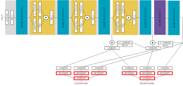

Palm Detection — Block Diagram 3 (Camera: AlbertaBeef)
The following block diagram is the same as the previous one, but this time showing details of the “BLAZE BLOCK B” patterns, which will required further discussion during the deployment phase.
Palm Detection — Block Diagram 4 (Camera: AlbertaBeef)

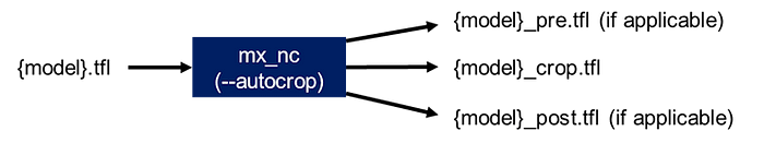

The MemryX SDK’s Neural Compiler is able to automatically identify unsupported layers, and isolate them with the “ — autocrop” feature. This feature will crop the part of the model that is supported for inference on the MX3 acceleration module (ie. “crop”), and isolate the initial layers (ie. “pre”) and/or final layers (ie. “post”) that are not supported:
MemryX Neural Compiler — autocrop (Camera: AlbertaBeef)
Initial exploration of the palm detection model reveals that the final reshape/concatenation layers of the model are not supported. This is reported as shown below for the 0.07 version of the palm detection model.
This script must be executed in the “mx” virtual environment. In not already done so, launch the “mx” virtual environment as follows:

In the case of the 0.07 version of the palm detection model, the autocrop generated the following models, indicating that there were unsupported layers at the end of the model:
  • {model}_crop.tfl
  • {model}_post.tfl
We can use netron.app to visualizethese unsupported layers:
Palm Detection — Unsupported RESHAPE/CONCAT Layers (Camera: netron.app)

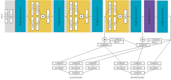

If we trace this back to our block diagram, these are the final layers of the model, as shown in red below:
Palm Detection — Unsupported RESHAPE/CONCAT Layers (Camera: AlbertaBeef)
These unsupported layers are in an ideal location (first or last layers), since the bulk of the model can execute entirely on the MX3 acceleration module.
Although we do not need to explicitly provide the names of these layers to the Neural Compiler, I chose to do so, in order to guarantee they were always in certain order in the compiled model. This is shown below for the 0.07 version of the palm detection model:

Here is the performance of these individual models, as well as the 0.10 versions:
Palm Detection + Hand Landmarks — single models — MX3 performance (Camera: AlbertaBeef)
For convenience, I have archived the compiled single models for MX3 in the following archive:
  • MX3 single models : blaze_mx3_single_models.zip (compiled with mx_nc version 1.1.0)
This archive also contains the 0.10 versions of the face detection + landmarks, and pose detection + landmarks models. Here is the performance achieved for each individual model on the RPI5 and on a HP Z4 G4 workstation:
MediaPipe — single models — MX3 performance (Camera: AlbertaBeef)
A Note about Context Switching
MemryX does not yet deal with context switching. If a model does not fit in the available resources (ie. 4 MXA devices), then it will not be supported. Another option is to use multiple accelerator modules.
MemryX does support multiple models, which can be specified directly at compile time:
MemryX Neural Compiler — Multi-Model support (Camera: MemryX)

Here is the performance of these palm detection + hand landmark multi-models, as well as the 0.10 versions:
Palm Detection + Hand Landmarks — multi models — MX3 performance (Camera: AlbertaBeef)
Note that the performance of each model has changed, compared to its individual performance. However, these have the advantage of being supported in a dual-inference pipeline.

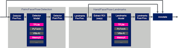

Model Execution
In order to support the MemryX models, the “blaze_app_python” application was augmented with the following inference targets:
blaze_app_python — support for TFLite and MemryX (Camera: AlbertaBeef)
My final inference code for the MemryX models can be found in the “blaze_app_python” repository, under the blaze_memryx sub-directory:
  • blaze_app_python/blaze_memryx/blazedetector.py
  • blaze_app_python/blaze_memryx/blazelandmark.py
Note that today, the MemryX inference can only be run on a computer (with a M.2 socket, populated with a MX3 module). This includes the Raspberry Pi 5, which I will cover in more detail in the next sections.
Setting up the Raspberry Pi 5 with the MemryX AI Accelerator
The following components were used to create the Raspberry Pi 5 setup:
  • [RaspberryPi] Raspberry Pi 5
  • [GeeekPi] GeeekPi N04 M.2 2280 HAT
  • [MemryX] MX3 M.2 Accelerator
Raspberry Pi 5 + M.2 Hat + MemryX MX3 M.2 Accelerator (Camera: AlbertaBeef)
Once assembled, our MX3-enabled RPI5 AI Kit looks like this:
MX3-enabled Raspberry Pi 5 AI Kit (Camera: AlbertaBeef)

If we plot the acceleration ratios of the execution times for the MX3 models with respect to the TFLite models, we get the following results:
Palm Detection + Hand Landmarks — MX3 Acceleration ratios (Camera: AlbertaBeef)
The models were accelerated by a factor of 7.2x and 4.2x, and the full palm+hand pipeline was accelerated by a factor of 4.0x.
Again, it is worth noting that these benchmarks have been taken with a single-threaded python script. There is additional opportunity for acceleration with a multi-threaded implementation. A better reference implementation for such a multi-threaded implementation would be MemryX’s very own implementation of the palm detection + hand landmarks example:

Competitive Comparison
At the start of this article I mentioned:
It is only fair to share what I mean by this statement. Overall, the MX3 M.2 accelerator is outperforming the Hailo-8L M.2 accelerator module and sometimes even the Hailo-8 M.2 accelerator module.
Here is a comparison of the complete line-up of mediapipe models that I have benchmarked, using the vendor’s own benchmarking tools:
Competitive Comparison : all models (Camera: AlbertaBeef)
The first thing to note is that:
  • MX3 is outperforming Hailo-8L for all models
If we zoom in the palm+hand models, we can observe:
  • MX3 is outperforming Hailo-8 for the 0.07 models
  • MX3 is outperforming Hailo-8 for the 0.10 palm detection models
  • Hailo-8 is outperforming MX3 for the 0.10 hand landmark models
Competitive Comparison : palm+hand models (Camera: AlbertaBeef)
If we zoom in on the face models:
  • MX3 is outperforming Hailo-8 for face landmark model
  • Hailo-8 it is outperforming MX3 for the face detection short range model
Competitive Comparison : face models (Camera: AlbertaBeef)
If we zoom in on the pose models:
  • MX3 is outperforming Hailo-8 for all the pose models
Competitive Comparison : pose models (Camera: AlbertaBeef)

    Thank you for pointing this out.
    The link is working now : avnet.me/mediapipe-05-rpi5aikit-element14
  • javagoza
    javagoza over 1 year ago
    Awesome. The third link doesn't work for me.
