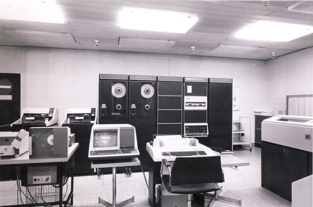

A PDP-11 machine. )Image Credit: Wikipedia)
