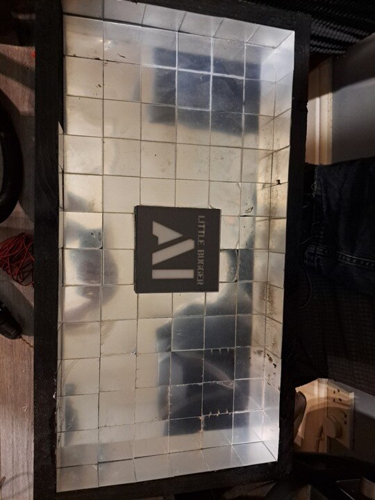

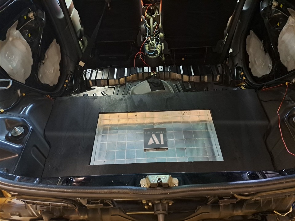

Rear “Circuit Display” System
One of the biggest custom fabrication parts of the project so far has been the rear AI circuit display.
The display combines:
  • mirrored surfaces
  • custom-cut perforated hex paneling
  • distributed controller mounting
  • RGB lighting systems
  • a custom illuminated “processor core”
  • visible modular electronics
The processor core has recently been redesigned to use an 8x8 LED matrix behind an opal acrylic diffuser after earlier LED strip prototypes produced uneven lighting results.
The controller layout has also already gone through several redesigns to improve:
  • symmetry
  • accessibility
  • cable routing
  • serviceability
  • visual balance
The aim is to make the display feel less like decorative RGB lighting and more like an exposed AI-powered electronic system.

Starting LBs circuit displayWhat started as a rectangle boardQuickly evolved into LBs circuit display. New red hex perforated plate looks wicked
Now it is looking like an AI DNA SYSTEMThis is where it goes in the car.

    Thank you, i will post updates soon. I hope to do tests on the voice visual very shortly. One of the s3 in the display is dedicated to the job using a neopxl at the 7 strips in the grill and running cat6 for data lines. I did post a question about this a bit back because i was getting interference when the voice of LB finished and it was supposed to drop back to knightrider scan mode but i have hopefully sorted that out now. As you can see it is all on the go at once, but it is coming along and hopefully be on the home stretch soon!!
