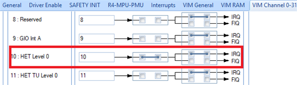

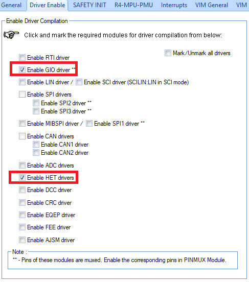

HALCoGen Configuration
The HET module is activated. Because I'm using two LEDs to show timer activity for demo purposes, the GIO module is activated too.
The design is interrupt based, so I activate the HET interrupt.

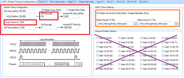

The HET module itself is where we set the loop resolution time:
To get 1 µs, play with the HR and LR pre-scalers. Smart people can do that by calculating.
I use trial and error. I set the Loop time to the time I want, 1000 ns.
Then I play with the HR pre-scaler, starting from the highest setting 63, down until the Actual LR Time is what I requested.
There are other ways of getting a 1µs sequence, with the pre-scalers and in the HET code.
This one makes for the simplest program.
The HET-compiled .h and .c files are selected on the right.
I've chosen to not set the lines that can generate an interrupt here in HALCoGen.
These settings are calculated and configured in the APIhuiInit() call, based on the number of counters you want to have.

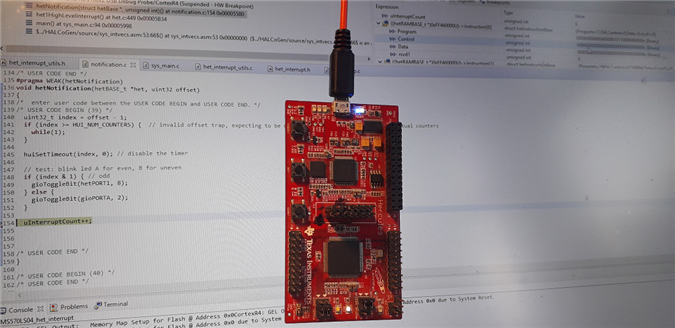

ARM Interrupt
#include "gio.h"
#include "het.h"
/* USER CODE BEGIN (0) */
#include "het_interrupt.h"
#include "het_interrupt_utils.h"
volatile uint32_t uInterruptCount = 0U;
/* USER CODE END */
#pragma WEAK(hetNotification)
void hetNotification(hetBASE_t *het, uint32 offset)
/*  enter user code between the USER CODE BEGIN and USER CODE END. */
/* USER CODE BEGIN (39) */
  uint32_t index = offset - 1;
  if (index >= HUI_NUM_COUNTERS) {  // invalid offset trap, expecting to be not higher than number of available virtual counters
    while(1);
  huiSetTimeout(index, 0); // disable the timer
  // test: blink led A for even, B for uneven, then increase a counter so that we know how many interrupts we received.
  if (index & 1) { // odd
    gioToggleBit(hetPORT1, 8);
  } else {
    gioToggleBit(gioPORTA, 2);
  uInterruptCount++;
/* USER CODE END */
When the HET module throws a registered interrupt, this function is called, and the offset represents the line of HET code that caused it +1.
Because each counter is a line of code, we can find the 0 based timer as offset - 1.
I've pu a test loop to catch if there's an unexpected interrupt. This hasn't happened.
Then (this is only if you want a timeout to fire only once), I disable the timer with a huiSetTimeout(timer#, 0) call.
All the rest is test code to give visual and programmatic feedback.
When an even counter timed out, I toggle LED A. When an uneven counter did it, I toggle LED B.
I also increment a test counter each time an interrupt is received. The test framework (next section) can then define a number of counters and control if the right amount of timeout interrupts resulted from that.
