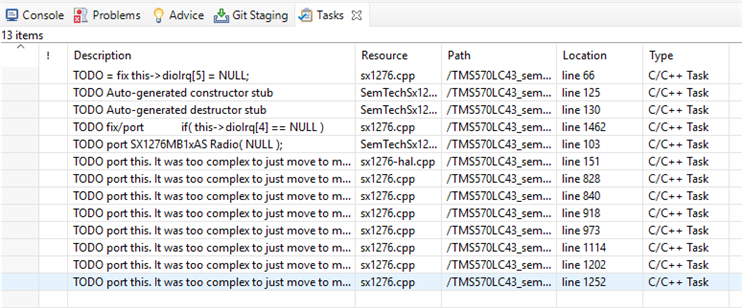

Some constructs are cumbersome to resolve, e.g.: the MBED Callback template construct.
In those cases, where it takes longer to do this exercise than it would be to build a final solution, I comment out the failing code and put a // todo: comment in the source.
Eclipse and other editors have a Task view that shows the things that have to be resolved in source code.
Work Items at This Stage
At this point, where there are 0 compilation errors left, we have a list of manageable work items.
    • All code in missing.h. Each of those will need a MBED-independent implementation.
      There's no need to implement it identical to MBED. But it's a good starting point. I think that the MBED object oriented abstractions are neat. Better than what I usually come up with.
    • The tasks in the Todo window. hose are all pieces of code you commented out but are needed for a working design.
      This is a good time to try and dig into those constructs, get a better understanding and create a solution that works on your non-MBED target platform.

    Jan Cumps over 6 years ago
    Some further progress
    The non-working project now compiles with 3 warnings left:
    The first one I have to look into. I'm using the correct linker file for my controller but one source somewhere seems to have a sections pragma.
    The 2 others are to be ignored, because they are a result of me commenting out code dependencies for things I have to write.
    Here are the to-dos to get the cycle closed:
    TODO DigitalIn.cpp /TMS570LC43_semtech_sx1276_cpp/cpp/implementation_dependent/client_platform line 11 C/C++ Task
    TODO DigitalInOut.cpp /TMS570LC43_semtech_sx1276_cpp/cpp/implementation_dependent/client_platform line 11 C/C++ Task
    TODO DigitalInOut.cpp /TMS570LC43_semtech_sx1276_cpp/cpp/implementation_dependent/client_platform line 15 C/C++ Task
    TODO DigitalInOut.cpp /TMS570LC43_semtech_sx1276_cpp/cpp/implementation_dependent/client_platform line 22 C/C++ Task
    TODO DigitalInOut.cpp /TMS570LC43_semtech_sx1276_cpp/cpp/implementation_dependent/client_platform line 27 C/C++ Task
    TODO DigitalInOut.cpp /TMS570LC43_semtech_sx1276_cpp/cpp/implementation_dependent/client_platform line 33 C/C++ Task
    TODO DigitalInOut.cpp /TMS570LC43_semtech_sx1276_cpp/cpp/implementation_dependent/client_platform line 38 C/C++ Task
    TODO DigitalOut.cpp /TMS570LC43_semtech_sx1276_cpp/cpp/implementation_dependent/client_platform line 11 C/C++ Task
    TODO DigitalOut.cpp /TMS570LC43_semtech_sx1276_cpp/cpp/implementation_dependent/client_platform line 18 C/C++ Task
    TODO DigitalOut.cpp /TMS570LC43_semtech_sx1276_cpp/cpp/implementation_dependent/client_platform line 25 C/C++ Task
    TODO InterruptIn.cpp /TMS570LC43_semtech_sx1276_cpp/cpp/implementation_dependent/client_platform line 11 C/C++ Task
    TODO SPI.cpp /TMS570LC43_semtech_sx1276_cpp/cpp/implementation_dependent/client_platform line 11 C/C++ Task
    TODO SPI.cpp /TMS570LC43_semtech_sx1276_cpp/cpp/implementation_dependent/client_platform line 15 C/C++ Task
    TODO SPI.cpp /TMS570LC43_semtech_sx1276_cpp/cpp/implementation_dependent/client_platform line 20 C/C++ Task
    TODO SPI.cpp /TMS570LC43_semtech_sx1276_cpp/cpp/implementation_dependent/client_platform line 24 C/C++ Task
    TODO = fix this->dioIrq[5] = NULL; sx1276.cpp /TMS570LC43_semtech_sx1276_cpp/cpp/sx1276/sx1276 line 68 C/C++ Task
    TODO Auto-generated constructor stub SemTechSx1276.cpp /TMS570LC43_semtech_sx1276_cpp/cpp line 126 C/C++ Task
    TODO Auto-generated constructor stub Timeout.cpp /TMS570LC43_semtech_sx1276_cpp/cpp/implementation_dependent/client_platform line 11 C/C++ Task
    TODO Auto-generated destructor stub SemTechSx1276.cpp /TMS570LC43_semtech_sx1276_cpp/cpp line 131 C/C++ Task
    TODO Auto-generated destructor stub Timeout.cpp /TMS570LC43_semtech_sx1276_cpp/cpp/implementation_dependent/client_platform line 16 C/C++ Task
    TODO fix tmath dependencies sx1276.cpp /TMS570LC43_semtech_sx1276_cpp/cpp/sx1276/sx1276 line 528 C/C++ Task
    TODO fix tmath dependencies sx1276.cpp /TMS570LC43_semtech_sx1276_cpp/cpp/sx1276/sx1276 line 578 C/C++ Task
    TODO fix tmath dependencies sx1276.cpp /TMS570LC43_semtech_sx1276_cpp/cpp/sx1276/sx1276 line 829 C/C++ Task
    TODO fix/port             if( this->dioIrq[4] == NULL ) sx1276.cpp /TMS570LC43_semtech_sx1276_cpp/cpp/sx1276/sx1276 line 1469 C/C++ Task
    TODO implement wait_ms( 1 ); sx1276-hal.cpp /TMS570LC43_semtech_sx1276_cpp/cpp/sx1276/sx1276 line 95 C/C++ Task
    TODO implement wait_ms( 1 ); sx1276-hal.cpp /TMS570LC43_semtech_sx1276_cpp/cpp/sx1276/sx1276 line 105 C/C++ Task
    TODO implement wait_ms( 1 ); sx1276-hal.cpp /TMS570LC43_semtech_sx1276_cpp/cpp/sx1276/sx1276 line 304 C/C++ Task
    TODO implement wait_ms( 1 ); sx1276.cpp /TMS570LC43_semtech_sx1276_cpp/cpp/sx1276/sx1276 line 108 C/C++ Task
    TODO implement wait_ms( 1 ); sx1276.cpp /TMS570LC43_semtech_sx1276_cpp/cpp/sx1276/sx1276 line 147 C/C++ Task
    TODO implement wait_ms( 1 ); sx1276.cpp /TMS570LC43_semtech_sx1276_cpp/cpp/sx1276/sx1276 line 665 C/C++ Task
    TODO implement wait_ms( 10 ); SemTechSx1276.cpp /TMS570LC43_semtech_sx1276_cpp/cpp line 228 C/C++ Task
    TODO implement wait_ms( 10 ); SemTechSx1276.cpp /TMS570LC43_semtech_sx1276_cpp/cpp line 243 C/C++ Task
    TODO implement wait_ms( 10 ); SemTechSx1276.cpp /TMS570LC43_semtech_sx1276_cpp/cpp line 268 C/C++ Task
    TODO implement wait_ms( 10 ); SemTechSx1276.cpp /TMS570LC43_semtech_sx1276_cpp/cpp line 302 C/C++ Task
    TODO implement wait_ms( 10 ); SemTechSx1276.cpp /TMS570LC43_semtech_sx1276_cpp/cpp line 321 C/C++ Task
    TODO implement wait_ms( 10 ); SemTechSx1276.cpp /TMS570LC43_semtech_sx1276_cpp/cpp line 332 C/C++ Task
    TODO implement wait_ms( 10 ); sx1276.cpp /TMS570LC43_semtech_sx1276_cpp/cpp/sx1276/sx1276 line 56 C/C++ Task
    TODO implement wait_ms( 6 ); sx1276-hal.cpp /TMS570LC43_semtech_sx1276_cpp/cpp/sx1276/sx1276 line 306 C/C++ Task
    TODO implement wait( 1 ); SemTechSx1276.cpp /TMS570LC43_semtech_sx1276_cpp/cpp line 158 C/C++ Task
    TODO implement wait(0.1); sx1276-hal.cpp /TMS570LC43_semtech_sx1276_cpp/cpp/sx1276/sx1276 line 140 C/C++ Task
    TODO port SX1276MB1xAS Radio( NULL ); SemTechSx1276.cpp /TMS570LC43_semtech_sx1276_cpp/cpp line 104 C/C++ Task
    TODO port this. It was too complex to just move to missing.h sx1276-hal.cpp /TMS570LC43_semtech_sx1276_cpp/cpp/sx1276/sx1276 line 153 C/C++ Task
    TODO port this. It was too complex to just move to missing.h sx1276.cpp /TMS570LC43_semtech_sx1276_cpp/cpp/sx1276/sx1276 line 925 C/C++ Task
    TODO port this. It was too complex to just move to missing.h sx1276.cpp /TMS570LC43_semtech_sx1276_cpp/cpp/sx1276/sx1276 line 980 C/C++ Task
    TODO port this. It was too complex to just move to missing.h sx1276.cpp /TMS570LC43_semtech_sx1276_cpp/cpp/sx1276/sx1276 line 1121 C/C++ Task
    TODO port this. It was too complex to just move to missing.h sx1276.cpp /TMS570LC43_semtech_sx1276_cpp/cpp/sx1276/sx1276 line 1209 C/C++ Task
    TODO port this. It was too complex to just move to missing.h sx1276.cpp /TMS570LC43_semtech_sx1276_cpp/cpp/sx1276/sx1276 line 1259 C/C++ Task
    TODO set for client board sx1276-hal.cpp /TMS570LC43_semtech_sx1276_cpp/cpp/sx1276/sx1276 line 137 C/C++ Task
    A lot of work but many are repeats.
    • 1 to 15 and 48 are code I need to write.
    • 17 to 20 are empty constructors and destructors. Some need work, some can stay empty
    • 21 to 23 are a little harder to resolve because I may have stumbled on a know error of my compiler. I may have to provide an own implementation for 3 tmath functions.
    • 25 to 40 can be fixed in a single throw. Just need to write 2 functions that implement wait() and wait_ms() for the target controller
    • 42 to 47 are the callback mechanism for interrupts. Todo.
    • 16 and 41: random activities
