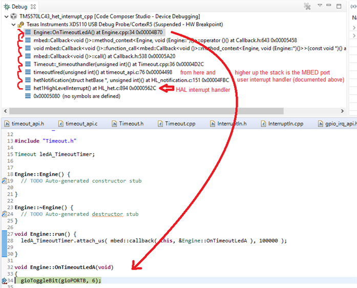

The port of the MBED Timeout works.
In this blog you can see the internals of this class and how to set up configuration and handling.
My port is for a Hercules TMS570LC43. I use the HAL utility and api for that controller where possible.
This was the most difficult part. The MBED Timeout inherits from Ticker. And that one inherits from TimerEvent.
There's good reasons for this. A Timeout is a Ticker that fires once. A Ticker is TimerEvent that can call a callbac method. A TimerEvent is a specialised class that only deals with setting and handling hardware timers and their interupts.
Like the majority of the MBED code, well designed, well abstracted.
I haven't done the same. I implemented everything in a Timeout class. My goal is to get SemTech's LoRa MBED example working on Hercules and I focus on that.
I spent some effort getting a flexible set of timers running with the Hercules high end timer module.
I'm reusing that development here.
The main take-away for this post is that I've created a function huiSetTimeout(index, us).
It activates one of the available timers, addressed by index that will throw an interrupt every given period (us, in microseconds). When you call that same function with 0 microseconds, it stops that timer.

I've created a class called Engine that will set a timeout and that has a handler method for it. It's instantiated and run at program startup.
  gioInit();
  hetInit();
  huiInit();
  _enable_interrupt_();
  Engine *engine = new Engine();
  engine->run();
Here's the declaration:
class Engine {
public:
  Engine();
  virtual ~Engine();
  void run();
protected:
  virtual void OnTimeoutLedA( void );
and the implementation:
Timeout ledA_TimeoutTimer;
Engine::Engine() {
  // TODO Auto-generated constructor stub
Engine::~Engine() {
  // TODO Auto-generated destructor stub
void Engine::run() {
  ledA_TimeoutTimer.attach_us( mbed::callback( this, &Engine::OnTimeoutLedA ), 1000000 );
void Engine::OnTimeoutLedA(void)
  gioToggleBit(gioPORTB, 6);
  // reprime. This is for testing purpose, so a flashing led is fun
The timer is created as a static variable, common in MBED and Arduino. Should it be a class member? Discuss.
A stack capture can help to understand the wind-down from low level interrupt handler to the handler method in our Engine object:
The result of this exercise is a Blinky that's driven by the Timeout class. The project and all code is attached.
