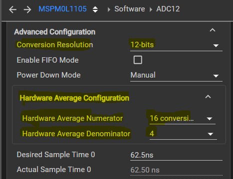

The design uses the 12 bit ADC peripheral options to oversample to 14 bits:
From the readme:
ADC12 Hardware averaging is configured to accumulate 16 samples and shift right by 4 to achieve 14-bit effective resolution.

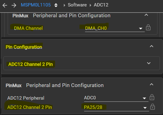

Use DMA to get 1024 samples - in low power mode. The selected input is ADC channel 2. On the EasyL1105, this is J2.9.

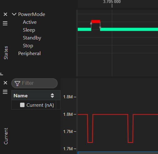

While ADC and DMA are doing their work in the background, we allow the controller to poll for completeness in a power saving mode:
        DL_ADC12_startConversion(ADC12_0_INST);
        while (false == gCheckADC) {
            __WFE();
The WFE arm assembler instruction
A usage for WFE is to put it into a spinlock loop. ... To save power, you can insert the WFE instruction into the loop so the CPUs instead of looping continuously will enter STANDBYWFE.

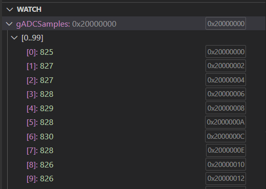

The gCheckADC flag gets set in the ADC interrupt handler, when DMA has finished loading 1024 samples:
void ADC12_0_INST_IRQHandler(void)
    switch (DL_ADC12_getPendingInterrupt(ADC12_0_INST)) {
        case DL_ADC12_IIDX_DMA_DONE:
            gCheckADC = true;
            break;
        default:
            break;
The ccs project with source and config files is attached. Thank you for reading.

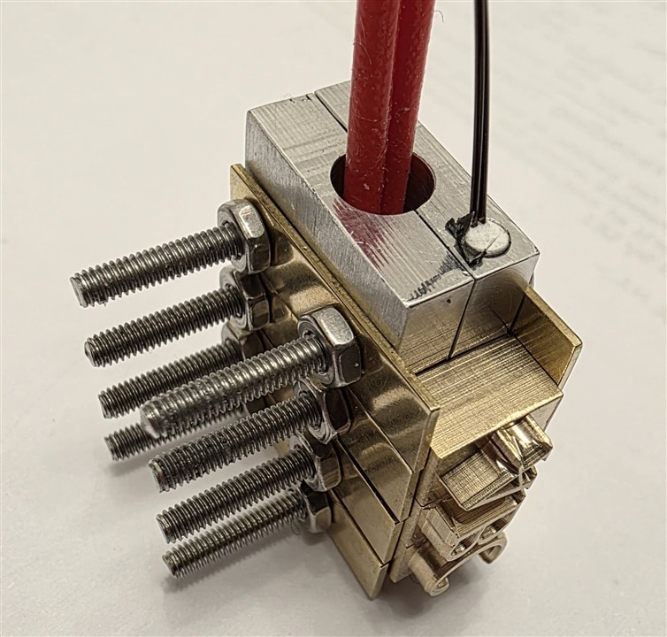

    shabaz over 1 year ago in reply to Jan Cumps

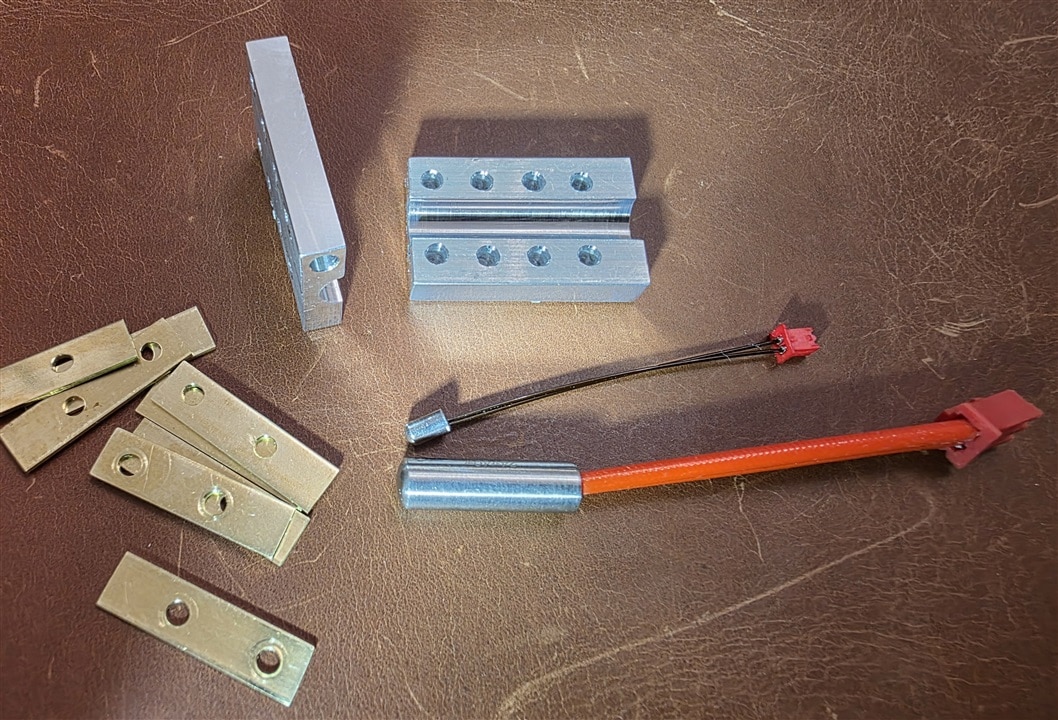

    The mechanics are now fairly complete.
    The heater is clamped between the two halves and the thermistor is friction fit. I used fragments of thermal grease replacement paper (Bergquist QPAD) to get a tight fit.
    The screws are a bit long, I need to trim those. Anyway, you can see how the metal punches are clamped in place.
    I need to make some sort of attaching plate, since it will obviously be too hot to handle. But aside from that, I can now work on soldering up a MOSFET to the MSPM0.
