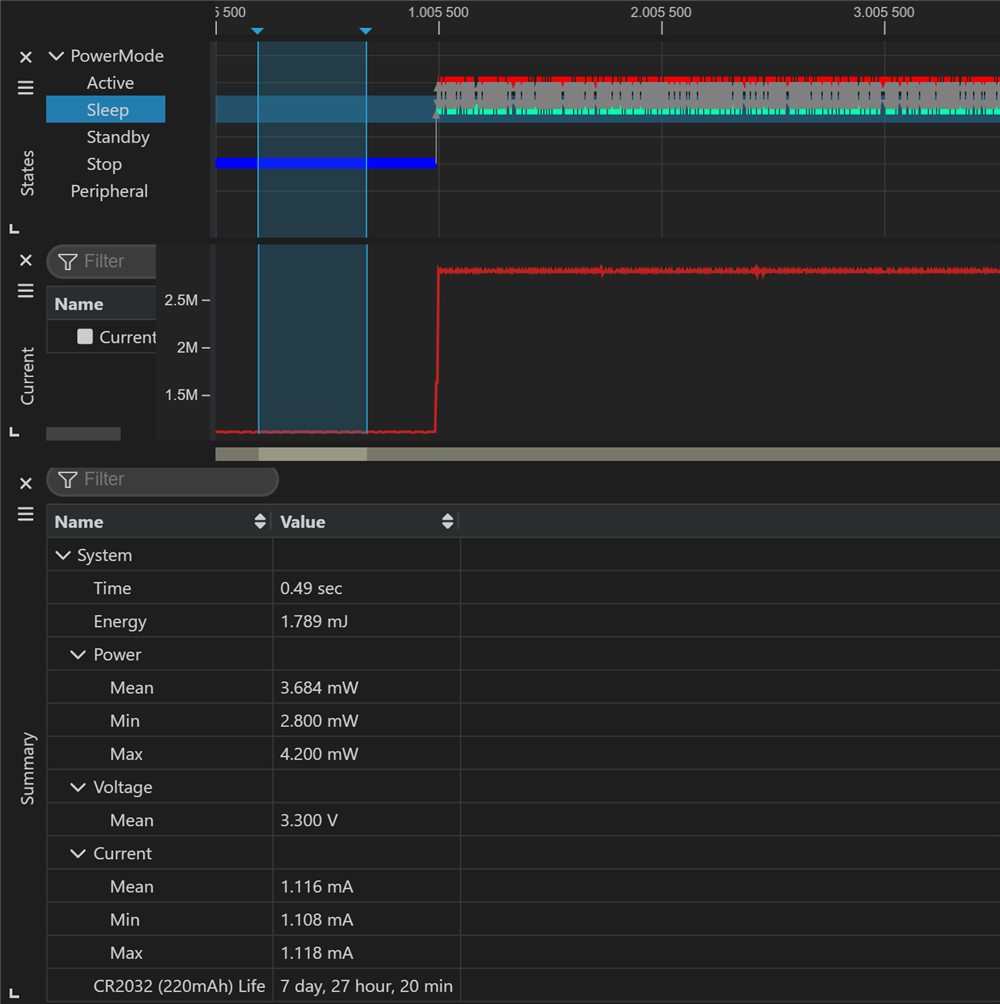

In the EnergyTrace capture below, you see 3 clear steps, showing 3 phases in the execution:
  1. stop mode, waiting for wake-up by the timer
  2. toggling between Sleep and Active, but comparator decides that LED has to be OFF
  3. same, but our ADC input dropped below VREF. The LED switches on and consumes significant current.

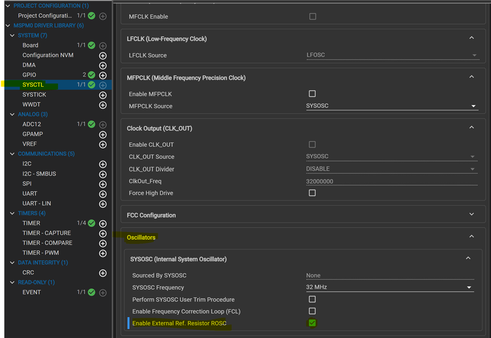

There's one change we have to do. Our LED is on P27. And it's a standard output (not open drain).
I've done a few other changes, to take care that the I2C (not used) pull-ups don't draw current.
Peripheral Function MCU Pin Board Pin Comment
GPIOA Output PA27/2 Green LED
I2C Open-Drain Output PA0/4 SDA not used open drain driven low for power saving (no current through pull-up)
I2C Open-Drain Output PA1/5 SCL not used open drain driven low for power saving (no current through pull-up)
TIMG1
ADC0 ADC12 Channel 2 Pin PA25/28 J2/9 signals below VREF will switch on green LED
EVENT
BOARD Debug Clock PA20 J14_4
BOARD Debug Data In Out PA19 J14_2
Last change I did, is flag that we have a resistor on board that stabilises the low frequency oscillator. This doesn't result in a measurable power save or loss. But we have it, so let's flag that:

Use a low burden voltage current meter (or better tools*1) to assess power usage.
EnergyTrace++
If you have an EnergyTrace compatible debugger, you can use it to analyse the power consumption in css:
1 an EEVBlog µCurrent with a multimeter or an oscilloscope,  or a bench meter (E.g.: Keythley DMM6500) will do the job.
