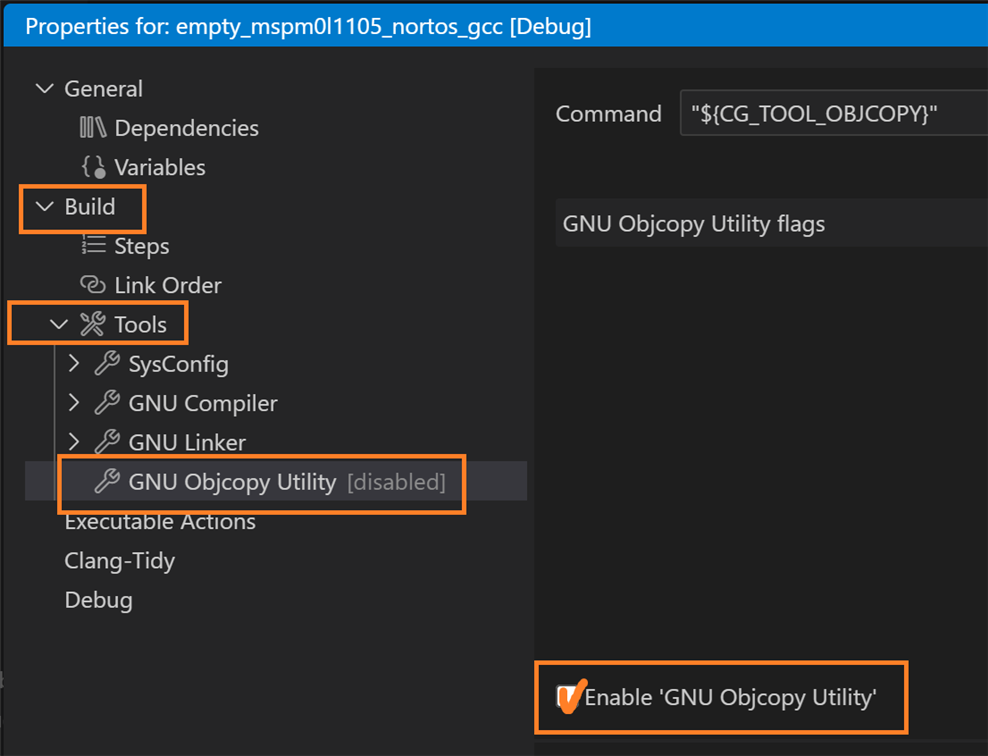

enable GNU ObjectCopy Utility

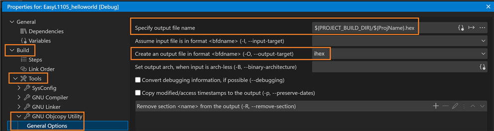

configure GNU ObjectCopy
  • output file name: ${PROJECT_BUILD_DIR}/${ProjName}.hex
  • format: ihex

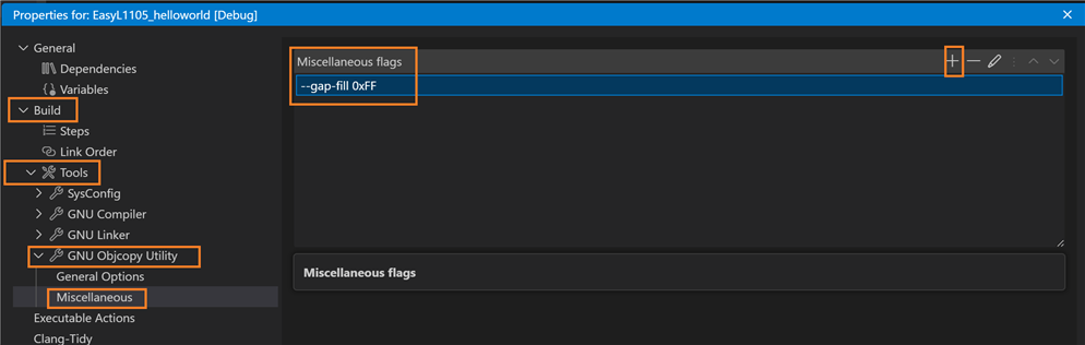

  • flags: --gap-fill 0xFF
That's all. You now have a compatible firmware binary

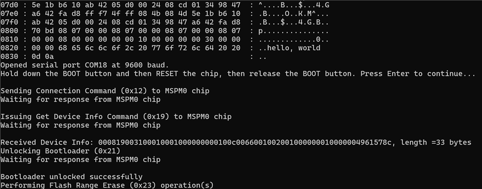

Programming the kit
This is explained in  EasyL1105: A Dev Board for the TI ARM Cortex-M0+ L-Series .
Here's my command line:
python3 "C:\Users\jancu\Documents\git\git_shabaz\easyL1105\mspm0_programmer\python\mspm0_prog.py" --port COM18 C:\Users\jancu\workspace_ccstheia\EasyL1105_helloworld\Debug\helloworld.hex
