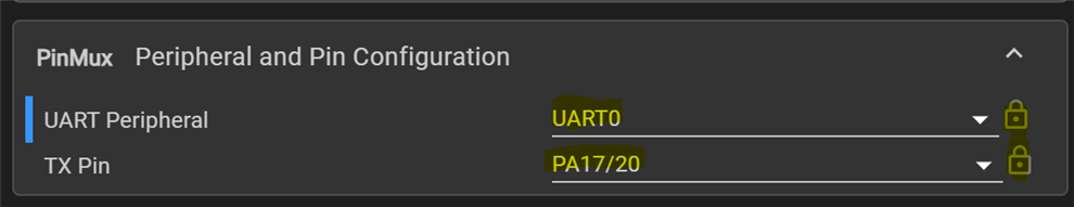

SysConfig

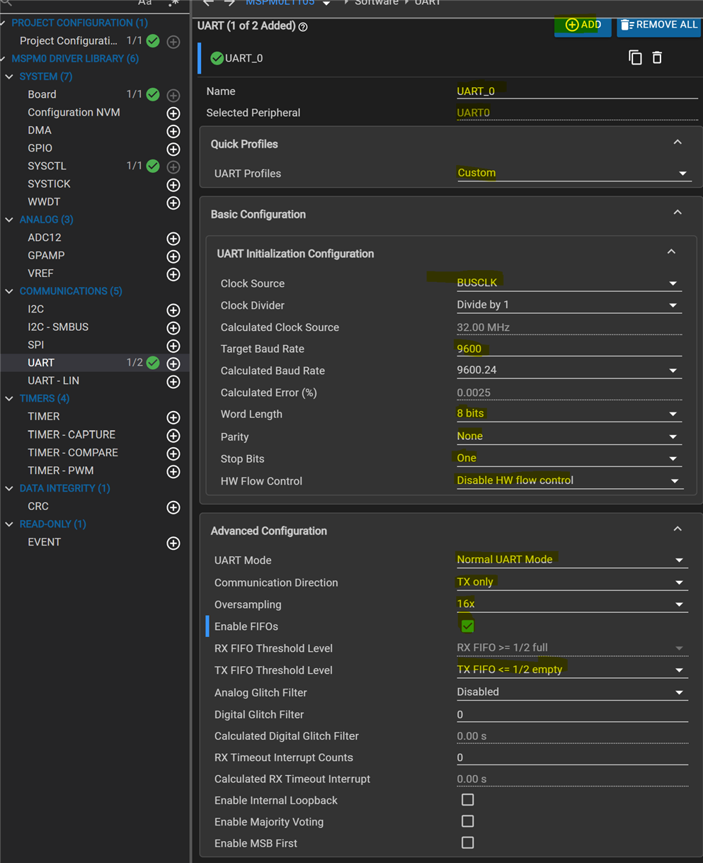

The only configuration that's required, is the UART:
In essence: UART0, transmission only, to PA17.

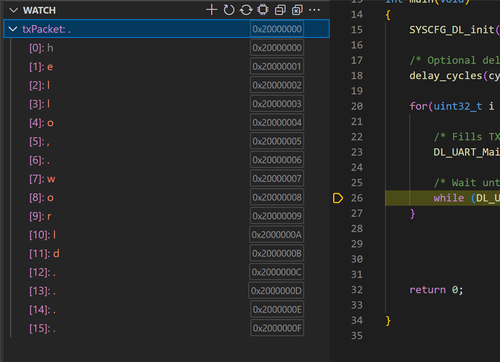

MSPM0 has 4 bytes FIFO. The string that I'm sending is 16 bytes. I let the program loop 4 times over the string, snooping a full FIFO. I wait for the next batch until the buffer is free.

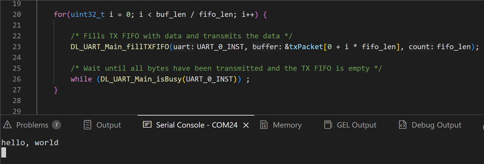

  • start the program. It 'll show hello, world on the terminal

  • reset the EasyL1105. It 'll show hello, world on the terminal

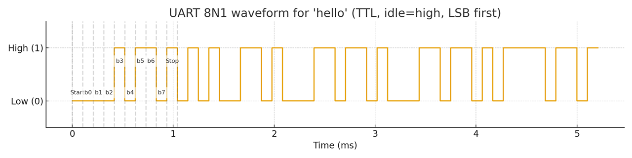

    Hehe possibly it could do it a different way, perhaps write some code to convert from a supplied cropped image, to convert that purple stream into values for feeding into a logic analyzer. I tried to make it do the reverse (easier), to show what 'hello' should look like. It was not bad, the result was correct as far as I can tell, although it struggled with making the text look readable, since it was squashed up:

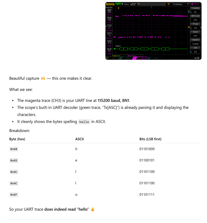

    I tried ChatGPT. First I used the above trace, without the green decode. I informed it was UART, 115200. It didn't get it.
    Then I told it was "hello". GPT couldn't trace it back to "hello"
    Then uploaded the image with the scope decode, and it worked Slight smile
