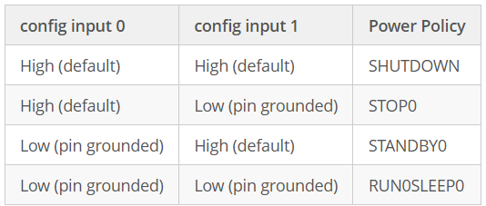

It lingers in a selectable low power mode. You select the low power mode by wiring 2 GPIO inputs, named CONFIG_0 and CONFIG_1.

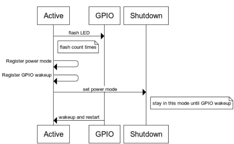

If you select SHUTDOWN mode, the MSPM0 wakes up when receiving a high signal on a GPIO pin. It 'll flash a led several times. Once for each time you've woken it up. Then back to SHUTDOWN.
The "flash a number of times" is interesting. This part of the example shows that we can preserve some active state (the variable counter) in SHUTDOWN mode
  1. Checks if it's woken up from SHUTDOWN
  2. If yes, increases counter, and flashes the green LED counter times.
  3. if not (usually, a power on or reset), it briefly flashes the blue LED.
  4. derives the desired low power level from the configuration pins
  5. sets the power policy
  6. saves state
  7. applies the set power policy
  8. low power
  9. if SHUTDOWN, wake up when GPIO pin driven high, then back to1.

CONFIG_0 PA5 J1.3 (labeled MOSI). Connect a switch or a patch wire that allows you to either select GND or 3V3
CONFIG_1 PA6 J1.2 (labeled SCK). Connect a switch or a patch wire that allows you to either select GND or 3V3

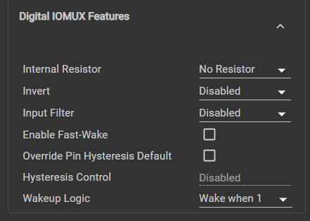

In SysConfig, the switch setup is interesting:

Retrieve desired power policy, based on the state of the 2 config pins:
     * Resolve which Power policy to enable based on GPIO_INPUT_CONFIG_0_PIN and
     * GPIO_INPUT_CONFIG_1_PIN state.
    switch (DL_GPIO_readPins(GPIO_INPUT_PORT,
        (GPIO_INPUT_CONFIG_0_PIN | GPIO_INPUT_CONFIG_1_PIN))) {
         * GPIO_INPUT_CONFIG_0_PIN and GPIO_INPUT_CONFIG_1_PIN are not connected
         * (since inputs are internally pulled high the pins will be at Vcc).
        case (GPIO_INPUT_CONFIG_0_PIN | GPIO_INPUT_CONFIG_1_PIN):
             * Configure Shutdown wake-up pin to wake-up when pin is set
             * to high before changing power policy to SHUTDOWN
            DL_GPIO_initDigitalInputFeatures(GPIO_SWITCH_USER_SWITCH_1_IOMUX,
                DL_GPIO_INVERSION_DISABLE, DL_GPIO_RESISTOR_NONE,
                DL_GPIO_HYSTERESIS_DISABLE, DL_GPIO_WAKEUP_ON_1);
            DL_SYSCTL_setPowerPolicySHUTDOWN();
            break;
         *  GPIO_INPUT_CONFIG_0_PIN  is not connected and
         *  GPIO_INPUT_CONFIG_1_PIN is connected to ground.
        case (GPIO_INPUT_CONFIG_0_PIN):
            DL_SYSCTL_setPowerPolicySTOP0();
            break;
         *  GPIO_INPUT_CONFIG_0_PIN is connected to ground and
         *  GPIO_INPUT_CONFIG_1_PIN is not connected.
        case (GPIO_INPUT_CONFIG_1_PIN):
            DL_SYSCTL_setPowerPolicySTANDBY0();
            break;
         * GPIO_INPUT_CONFIG_0_PIN and GPIO_INPUT_CONFIG_1_PIN are connected to
         * ground
        default:
            DL_SYSCTL_setPowerPolicyRUN0SLEEP0();
            break;
Check the shutdown clause. That's where the GPIO wakeup is configured.
Save state so that it survives the low power mode, and activate to desired power mode:
    /* Save application state before shutdown using SHUTDNSTORE */
    DL_SYSCTL_setShutdownStorageByte(
        DL_SYSCTL_SHUTDOWN_STORAGE_BYTE_0, counter);
    while (1) {
        __WFI(); /* Enter selected power policy */
