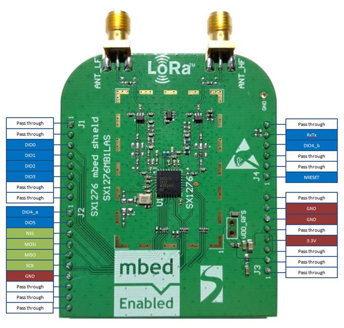

The SemTech SX1276 LoRa library uses the InterruptIn class to handle the digital signals DIO0 -> DIO5.

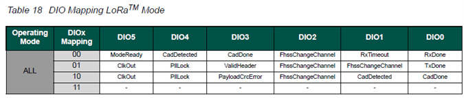

The pins DIO0 to 5 are used by the radio to flag changes within the system. These are configurable.
In the example that comes with the SX1276 shield, the first line in the below table is used.
DIO0 switching from high to low flags thet receiving is finished, etc ...
Each of the six pins have unique flagging function and the SX1276 library handles them in an object oriented way.
(note: Pin DIO5 is ignored in this example. There's a handler that's never called. Interrupts are not generated for it.

The 6 SX1276 DIO pins are connected to 6 gpio pins of the Hercules. I have to choose pins that support interrupts for the first 5.

In the class that represents the evaluation board (a subclass of the SX1276 class) the hardware specific things are done,
like assigning the hardware pins and set rise time triggers.
SX1276MB1xAS::SX1276MB1xAS( RadioEvents_t *events ) :   SX1276( events, D11, D12, D13, D10, A0, D2, D3, D4, D5, D8, D9 ),

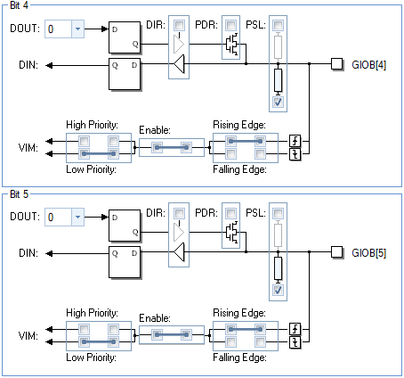

Here's how I defined them in the Hercules specific HAL configuration utility HALCoGen:
and
The effect of this configuration (Hercules specific) is that a low level handler (a single one, called for any of the pins)  will be called on the rising edge of these pins.

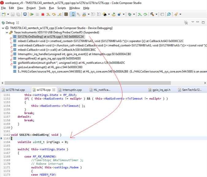

The result of an interrupt firing can be seen in the stack trace below.
In this example, the pin DIO0 lipped from low to high.
From bottom to top, the first 3 functions in the stack are from the Hercules low level HALCoGen layer.
Level 0: An assembler function (that I did not write image - it's generated by the utility) that looks in the interrupt table and calls the low low level handler.
Level 1: That low low level handler does some bookkeeping that's not supposed to be altered, then calls the user changeable handler gioNotification().
Level 3: In this handler (documented above) I query the edge that triggered the interrupt and hand over to my ported MBED interrupt code.
Level 4: My bridge function looks up which handler reference is linked to this pin and edge.
Level 5 and above: This is the default MBED ported code that will then call the method of the correct object. In this case the OnDio0Irq() method of my radio object.
