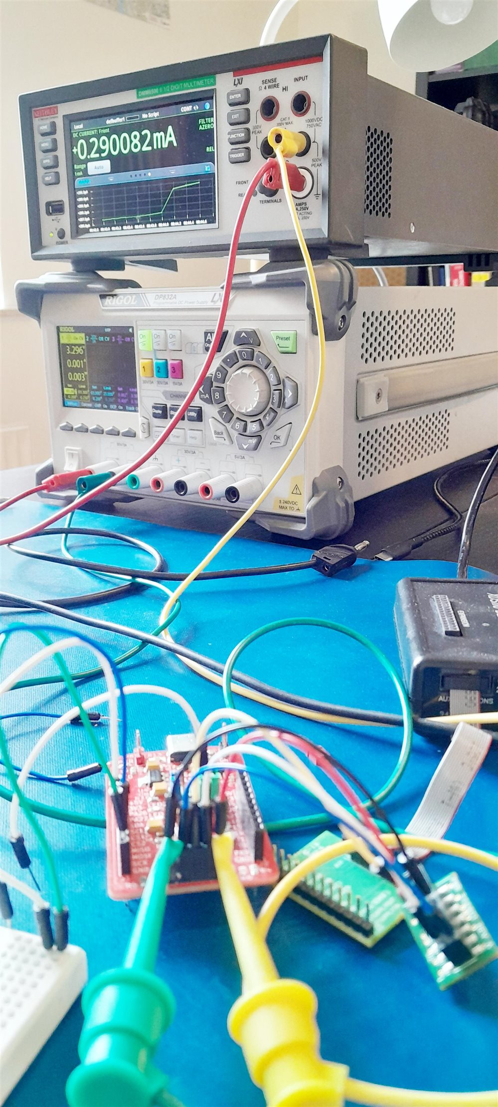

These are the measurements, made with a Keithley DMM6500. Power is supplied by a Rigol DP832A.
All jumpers to the USB side disconnected, no pullups/-downs removed.

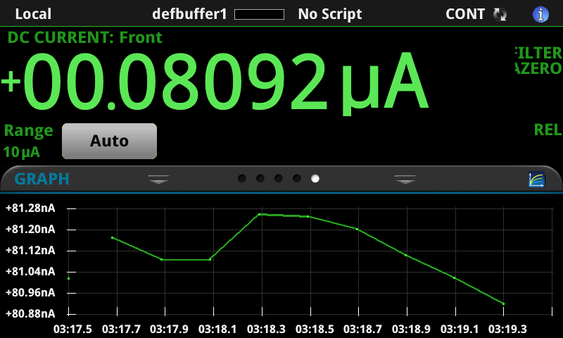

Lowest I managed to run the design, in SHUTDOWN, is 77 nA.

    Jan Cumps over 1 year ago in reply to DAB
    It doesn't change. I repeatedly get that current. It drops down to close of the min value. Then takes a few seconds to bite off the last nanoamps
