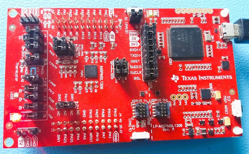

For this post, you need a debugger. If you use a LaunchPad, you already have one ( Cheap debugger ($6) for EasyL1105 MSPM0 board ). The example is configured for TI's XDS110.

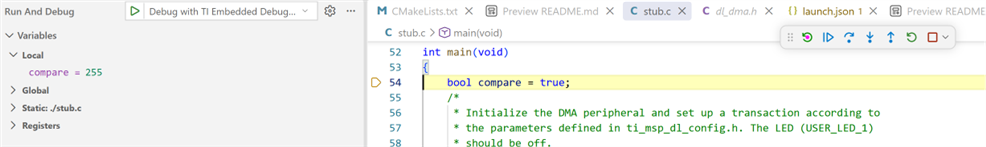

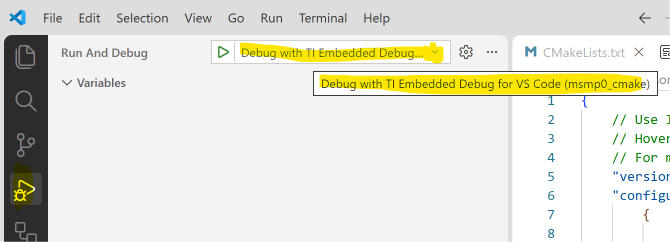

    Now all is ready. Press Run and Debug in the left toolbar. Select the debug configuration you just created. Then press the green button.
    If all is well, the debugger programs the MSPM0, then starts execution and stops on the first line of main:

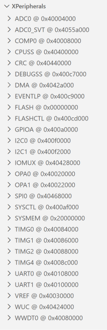

    If you also installed TI's extension Cortex-Debug: Device Support Pack - Texas Instruments MSPM0, you can also see (and change) the Peripheral registers. To do that, select View -> Open View -> xPeripherals:
