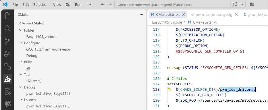

In this blog series, I build a Texas Instruments MSPM0 example with VS Code as IDE, and CMake as build infrastructure.
In posts 1 - 3, I created an end to end flow, from install over build to debug.
In post 4: testing it out on the EasyL1105: A Dev Board for the TI ARM Cortex-M0+ L-Series with a blinky.
Project and Changes
I used TI's existing pwm_led_driver example for the L1105 (project is attached at the end of this post).
Changes to SysConfig:
  • different GPIO for LED:
    the code I attached uses PA14, to reflect my setup. I have a blue LED on PA14..
    If you use an unaltered EasyL1105 board, edit pwm_led_driver.syscfg and change PA14 to PA26 on line 27. That's where one of its LEDs sits.
Changes to the scripts:
  • in CMakeLists.txt I changed the project name, and the file names of the sysconfig and .c file
  • in launch.json, I changed the device to MSPML1105 on line 32

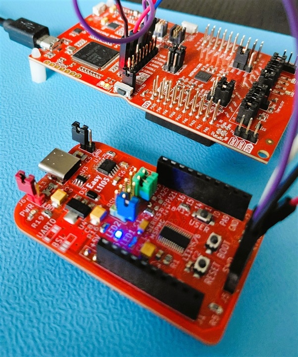

Debugger
I used the on-board XSD110 from one of my LaunchPads. Works equally well with a standalone XSD110.
On the EasyL1105, I removed all jumpers (in particular the power ones). On the LaunchPad, I removed all jumpers that connect the debugger to the controller. Then I routed Ground, 3V3, nRST, SWDIO and SWCLK from debugger to EasyL1105 J5 (SWD connector).

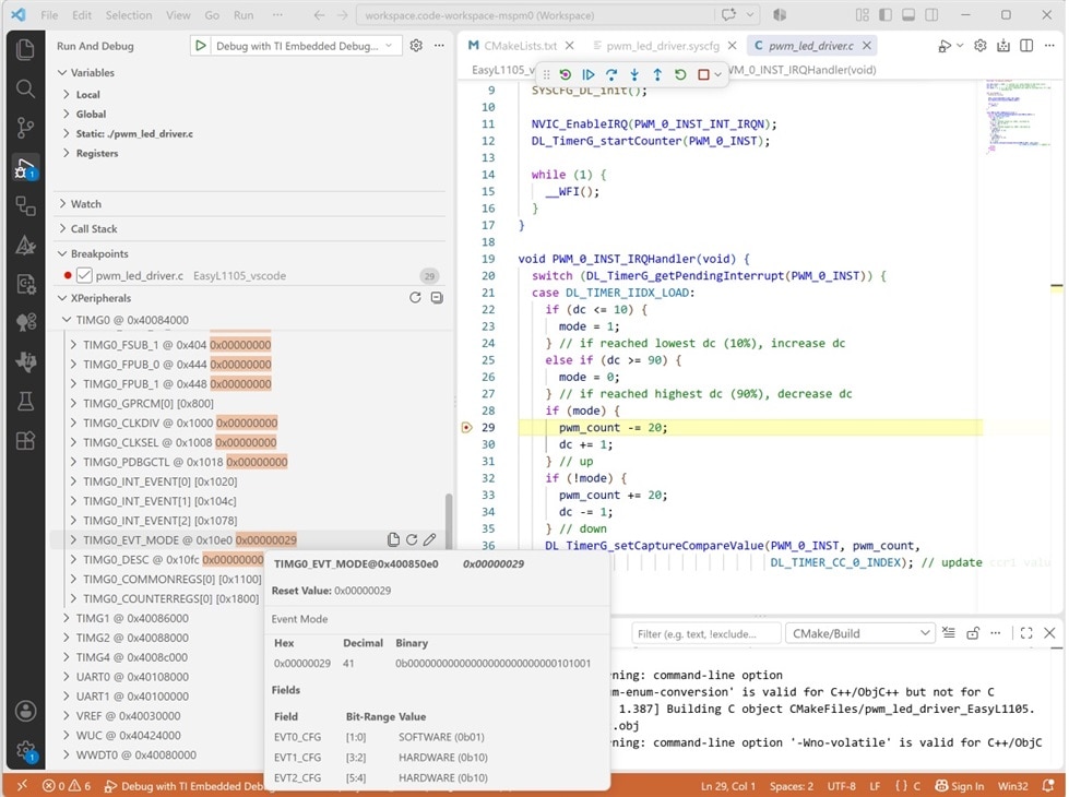

I selected the project in VS Code CMake extension. Selected GCC toolkit. Config, Build.
After that, started a debug session. All worked. The code got loaded on the MSPM0L1105, and the LED started glowing...
The build script also generates a .hex firmware compatible with shabaz'  python programmer.

    Jan Cumps 2 months ago in reply to Jan Cumps
    and also replace this:
    # Libraries and linker command files
    target_link_libraries( ${PROJECT_NAME} PRIVATE
        ${SYSCONFIG_GEN_LNKCMD}
    with
        ${SDK_ROOT}/source/ti/driverlib/lib/gcc/m0p/mspm0l11xx_l13xx/driverlib.a
    SysConfig makes a file that contains all libraries to link to. Called device.lds.genlibs
    If you don't use the generator, you 'll link those libraries in yourself.
    note: these libraries do not have to be mentioned:
    • gcc
    • c
    • m
    • nosys
    the toolchain pulls the right ones in, based on the flags used in the CMake script (e.g.: --specs=nano.specs)
    Jan Cumps 2 months ago in reply to shabaz

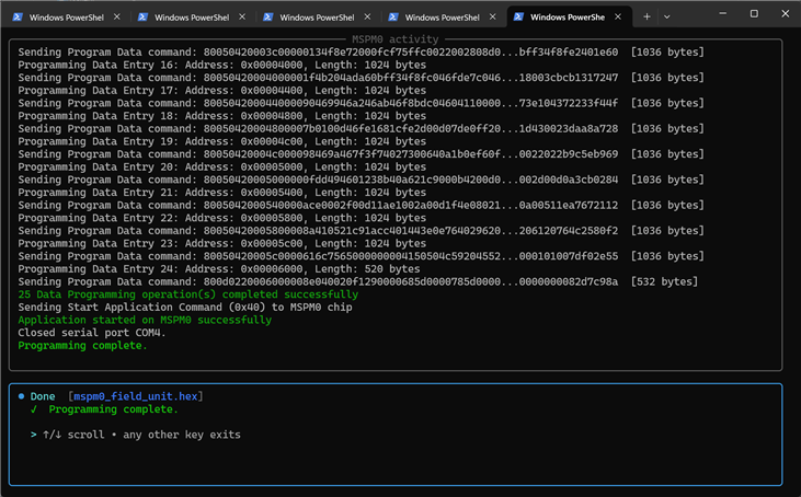

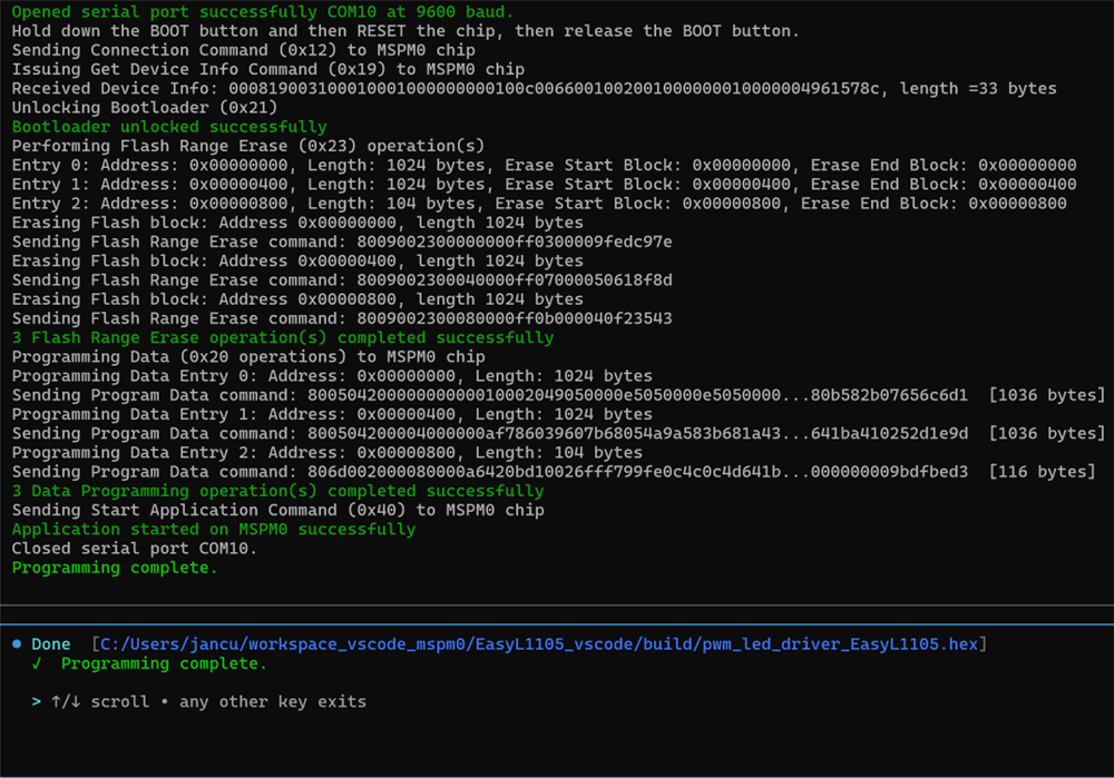

    I tested the new Python version, and works Slight smile
    command used:
    python3 C:\Users\jancu\Documents\git\git_shabaz\easyL1105\mspm0_programmer\python\mspm0_prog.py --port COM10 C:/Users/jancu/workspace_vscode_mspm0/EasyL1105_vscode/build/pwm_led_driver_EasyL1105.hex
    > would it be possible to have a the CMakeLists.txt file not generate the sysconfig output, perhaps if specified somehow, or if the sysconfig file is not present?
    Running the configurator, and including the dynamically generated files, is the most complex part of the script.
    If you don't need that, you can delete the whole SYSCONFIG section, and directly deal with these 3 files:
    ti_msp_dl_config.c: add it to the executable set of sources, together with any other c file.
    ti_msp_dl_config.h should be in the "include path". Either the project root, or a folder pointed to in
    # Directories searched for header files
    include_directories(
        # folder where ti_msp_dl_config.h is
    The  linker file: you''ll need to add the right one from the SDK. You should replace the line that sets the CMAKE_LINKER_FLAGS with:
    set(CMAKE_EXE_LINKER_FLAGS "${CMAKE_EXE_LINKER_FLAGS} -Wl,-T${SDK_ROOT}/source/ti/devices/msp/m0p/linker_files/gcc/mspm0l1105.lds")

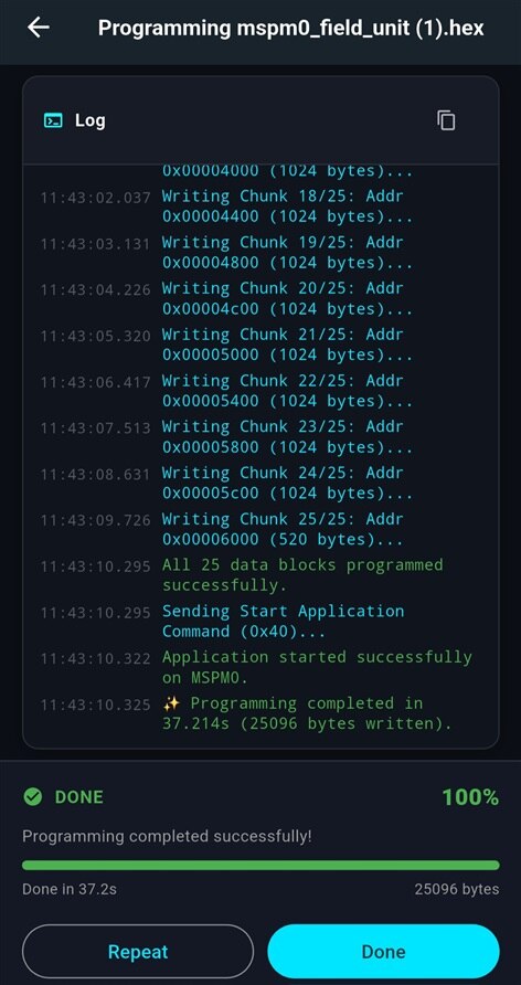

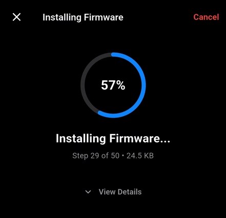

    The MSPM0 Python programmer has just recently been updated, I set AI on it, to give it a decent scroll buffer, and also show the status at the bottom. Now it looks like a real text-based app.
    Also, there is an Android port, here:
    https://github.com/shabaz123/easy_mspm0_prog/releases/
