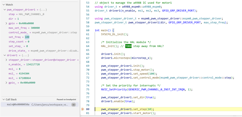

    Jan Cumps 2 months ago
    I got good progress on MSPM0 and steppers. First understanding that TI example above was key.
    What I'm doing now, is to port a Pico design that I made, to the MSPM0.
    What's the same: I'm using a very similar stepper IC driver class, that I wrote for the A4988 IC. Just switched from Pico SDK API to TI's.
    What's different:
    My Pico design ran the stepper logic on PIO state machines. The MSPM0 family doesn't have anything like that.
    For the MSPM0 I use the PWM timer capability, and interrupts. Leaning strongly on TI's example.
    I have a simple example working, that either can spin a motor at a given speed, or that can take a number of steps.

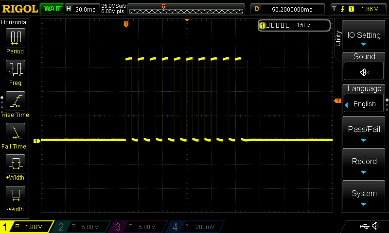

    Here, the STEP pin when asking the firmware to take 10 steps:
