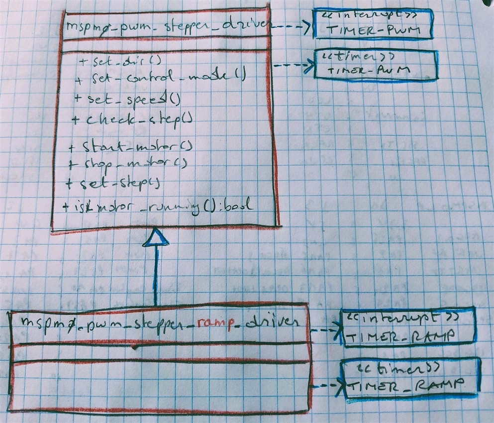

My Pico projects used the PIO state machines as steppe motor STEP and DIR controllers. MSPM0 doesn't have anything like that, but they have capable PWM timers. I used those, and stayed as close as I could to how TI controls them in their stepper motor middleware example.
I replaced TI's DRV8889 middleware C driver with my own C++ class. I tried to stay as true as possible to TI's API breakdown.

This class can generate PWM for step and for spin. There is control for constant speed.
In step mode, it relies on a PWM interrupt to call it every time it steps.

This is a work in progress. In the next post, I try to provide (s-shaped?) ramp up and down. And probably go HAL all the way.

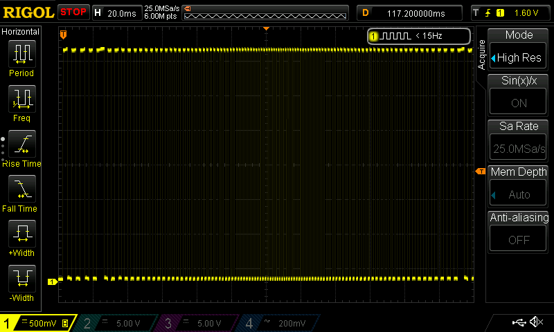

    Jan Cumps 19 days ago in reply to Jan Cumps
    Nearly done. I get a nice up and down ramp
    Not perfect yet. The think that the very last pulse's up-time is too short ...

    start_motor() will have to start the additional timer, and stop_motor() has to stop it
    The ISR check_steps() will have to be modified, to flag if we need to ramp up, stay steady, or ramp down. It 'll have to do that additionally to its current task to count steps.
    And a new ISR for the ramp timer will then have the duty to adjust the speed setting (alter PWM frequency), based on that flag.
    The step timer interrupt will need to be of higher priority. We don't want to miss a step count.
    Jan Cumps 19 days ago in reply to shabaz
    The plan is to write a specialised class, based on the one that I made for this post.
    If all is works out, the class members of the ramp class could override the base class ones, and wrap the ramps.
    Using linear or ramp, would require a change in one line of code:
    using pwm_stepper_driver_t = mspm0_pwm_stepper_driver::mspm0_pwm_stepper_driver;
    or
    using pwm_stepper_driver_t = mspm0_pwm_stepper_driver::mspm0_pwm_stepper_ramp_driver;
    The ramp logic will need one normal (not PWM) timer, that kicks off the checks to validate if a speed change is due.
