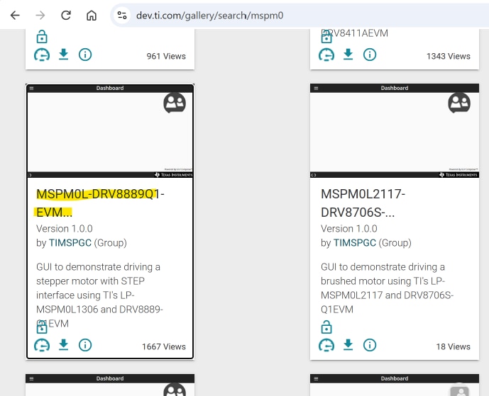

TI's Gallery has the example that I want to start from: MSPM0L-DRV8889Q1-EVM-GUI.
When you click the tile, it will open GUI Composer. From there you can run the GUI. First, plug in the the MSPM0L1306 LaunchPad.

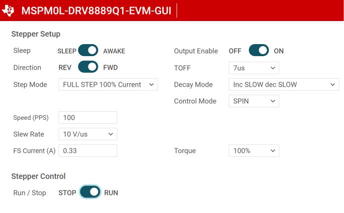

Then run the GUI. It will connect to the LaunchPad, and load the firmware.

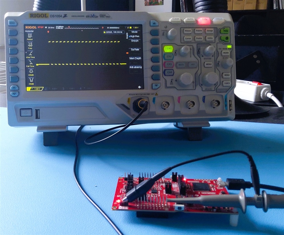

You can then configure the driver, and make the motor spin or step. Because I don't have the right hardware for this example, I tested it by probing the step pin output with an oscilloscope.
It works.

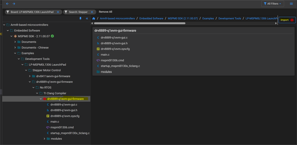

I used Code Composer Studio to download and inspect TI's firmware project. The project is available in Resource Explorer. You can import it from there.
I first compiled and loaded the project. That worked perfectly. Then I inspected sources and project settings, to understand how the project is set up:
  • most peripheral config is done via SysConfig
  • it uses the middleware HAL and stepper driver drv8889-q1. They are copied from the MSPM0 SDK.
  • the main function runs a GUI style loop.
  • custom GUI code reacts on messages coming from the GUI Composer application, over UART using JTAG and direct variable binding between GUI and firmware.
  • driverlib and IQMath libraries are used

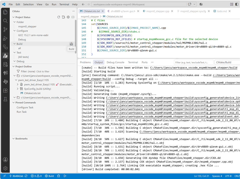

Port to  VS Code
I started from  MSPM0 project with VS Code, CMake and GCC - part 6: empty "template" project , and reused these files from the CCS project:
  • main
  • GUI code
  • sysconfig
I didn't copy over the module files. I adapted the CMake script, to find and include them in their SDK location during build.
In the original sysconfig file, project generation was disabled. TI does that in several of their examples, because they use other tools to prepare example projects.
I re-enabled that. Then I changed the setup, so that sysconfig generates the instructions to include the correct two libraries.
All worked fine. The VS Code project is attached.
