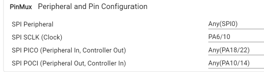

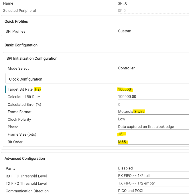

The DRV8711 is controlled over SPI, so I'll need to enable the SPI peripheral.

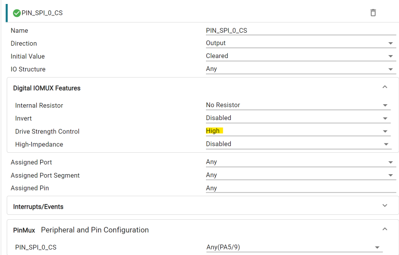

The DRV8711 requires that the CS is asserted over multiple data exchanges, so I have to implement a manual CS. That's why I selected 3-wire SPI.
Also, the CS works active high. It's different than most SPI ICs.
Here's the CS definition:
I had to select a high drive strength pin, because normal drive didn't get the job done.

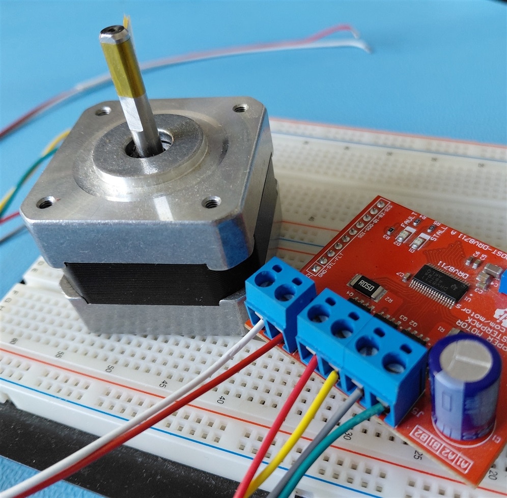

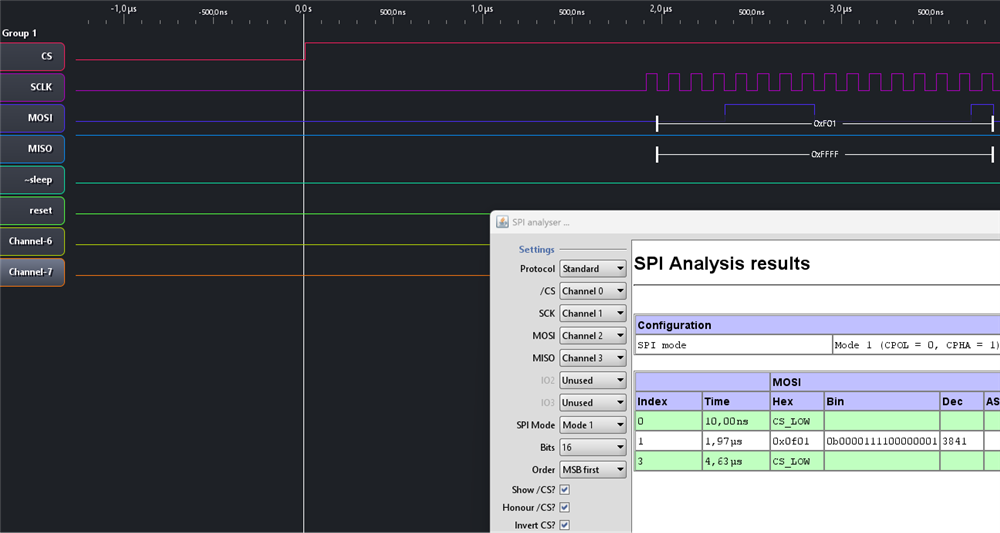

Before trying the design with a motor, I checked if the SPI conversations work, with a logic analyser:
All good. And when I tried to spin a stepper motor, it worked right away. Spot the smooth operation, driven with s-curve accelerator and decelerator patterns.
