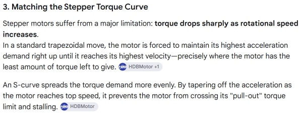

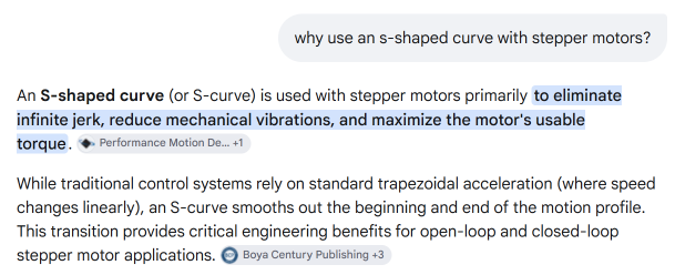

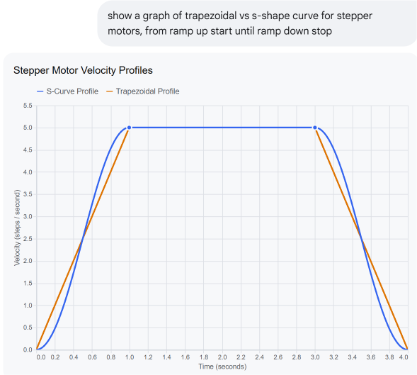

I asked AI:

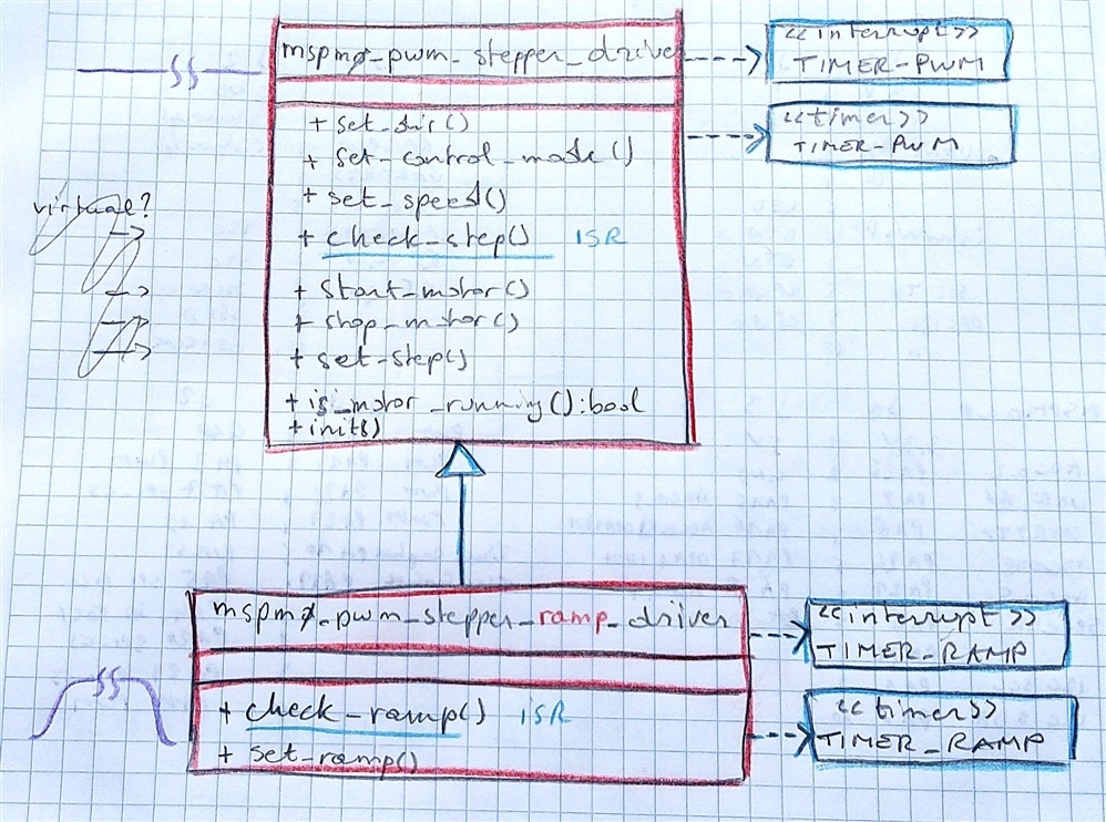

Object Oriented approach
I created a class for the constant stepper (see previous post). This class can manage the motor while it's performing the requested number of steps:
  • (in this case constant) speed
  • direction
  • start
  • step until done (count and stop)
I based a new s-curve capable class based on that one. It adds this functionality:
  • accept a ramp profile ( set of speeds)
  • decide when to ramp up or down
  • handle the ramp speeds
additional controller resources needed

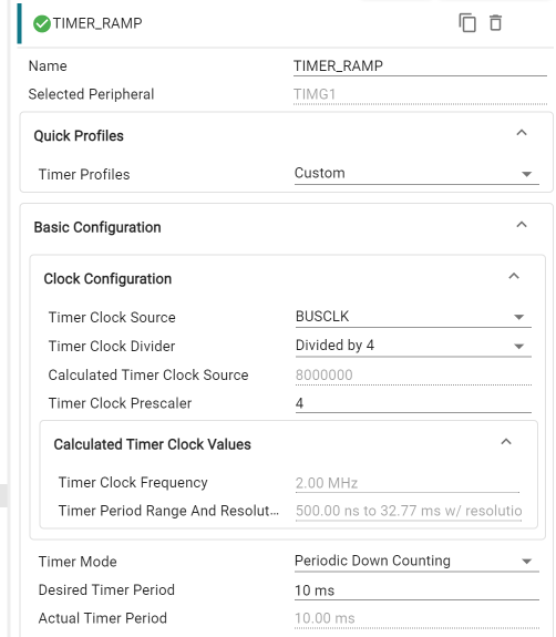

The logic needs an additional timer. A traditional one this time, not a PWM one like the one that generates the pulses. The firmware will have to provide a handler for that timer, that calls the classes check_ramp() method:
    void TIMER_RAMP_INST_IRQHandler(void) {
        if (DL_Timer_getPendingInterrupt(TIMER_RAMP_INST) == DL_TIMER_IIDX_ZERO) {
            pwm_stepper_driver1.check_ramp();
I've set up the timer to tick each 10 ms. The ISR then asks the class to "manage the ramp".
Based on the state (ramping up / ramping down / cruise), it either ramps up, ramps down, or does nothing.

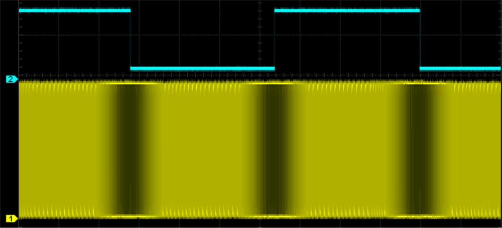

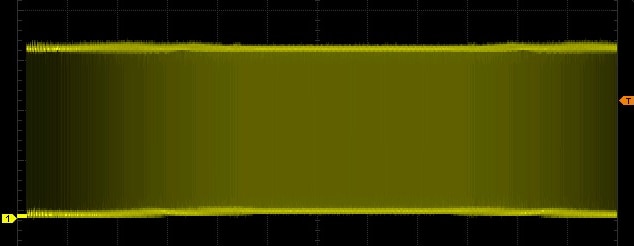

The image below shows a scope trace of a 5000 steps command, with ramps. The more intense the yellow, the more steps per second.

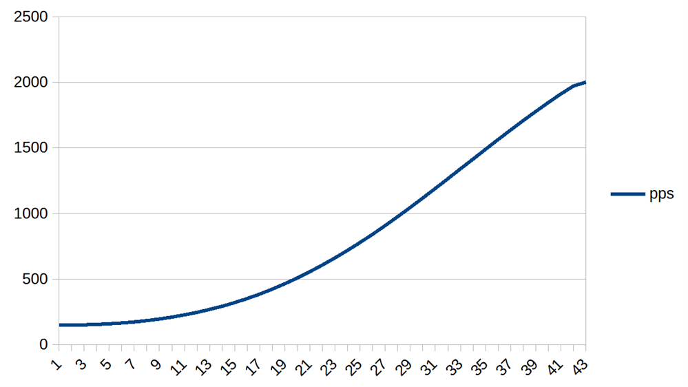

    I asked Google AI to come up with curves. I defined the number of steps and the desired plateau. Here's an example for 43 steps, 200 PPS max:
    inline static const std::array<uint32_t, RAMP_STEPS> s_curve_lut = {
        150,  151,  152,  155,  160,  166,  174,  184,  196,  211,
        228,  247,  269,  293,  321,  352,  386,  424,  465,  509,
        557,  608,  662,  719,  779,  842,  908,  976,  1046, 1118,
        1191, 1265, 1340, 1414, 1489, 1563, 1636, 1707, 1777, 1845,
        1910, 1971, 2000
    The code will use the table you give it, so you can play with shape, and how fast/slow you want to ramp.
