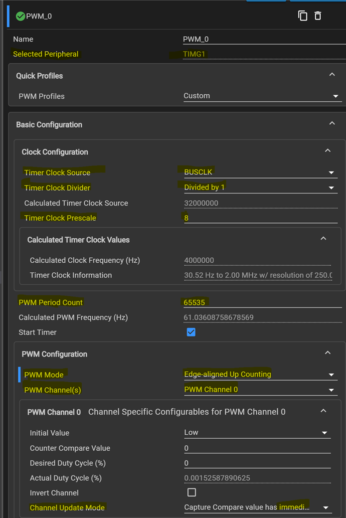

Set up PWM SysConfig

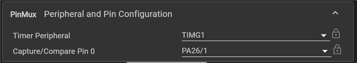

The code uses timer TIMG1, channel 0, to drive PA26. There's no interrupt involved. The duty cycle gets adjusted in the regulation loop.
At this point, I have set the PWM period count to 65535, in an attempt to have the output range identical (but 32768 offset) to the input.

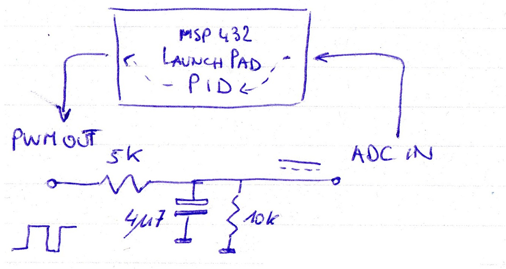

Demo circuit
I used the same (random) low pass filter as in  MSP432 and TI-RTOS: PID Library Part 2 - Real World Example , to turn the PWM into a DC signal.
The filter sits between PWM out  (P26) and ADC in (PA25).
