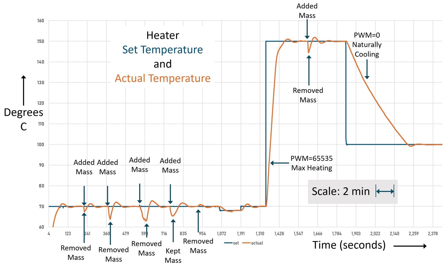

    After a lot of tweaking, it's still not perfect, but I think acceptable.
    For the results in the chart below, I initially set a temperature of 70 degrees, and experimented with adding an aluminium thermal mass on top briefly to force the temperature down by a few degrees, and then removing it to see the response back to the set temperature.  I kept the mass on top at one stage (labeled Kept Mass), to see the temperature recover with the mass present too.
    Then, I reduced the set temperature by two degrees to 68 degC, then increased it back to 70 degrees, then set it to 150 degC, then again did the thermal mass test, then finally turned the set temperature down to 100 degC.
    From the chart, what can be determined is that there is overshoot, I struggled to tame that, and didn't succeed. The overshoot is usually under 1.5 degC, but under certain conditions (such as deliberately cooling the system by about 6-8 deg C by temporarily adding a thermal mass and then removing it), when it tries to recover, the overshoot can reach about 2.5 degC.
    The damping occurs reasonably well, the error is under 0.5 degC often within the first oscillation, before it dampens out. Maybe it would be better for the system to slowly approach the temperature so that it doesn't overshoot or undershoot at all.Or maybe I'm being too picky. Apparently 3D printer hot end control systems overshoot too, and even 5 degC is considered acceptable for that use-case.
    The undershoot shown in the chart below (when lowering the set temperature) is better than the overshoot; usually under 1 degC.
    The PID code is complicated now, it kicks in the 'I' portion only within a certain range for instance. I relied heavily on Chat GPT to handle that.
    In summary, although it functions, I'm sure performance could be improved a lot, by control system experts. But, for the actual end application (heating punches for leather), and probably a whole load of other applications, I think the current performance may be acceptable (it took an entire day of tests and tweaks to get it to this state: (
    I hope the control system doesn't have any unexpected behavior under certain conditions, but I'll find out over time, as it gets used. I need to move on to the PCB, to get the project into at least a usable state.
