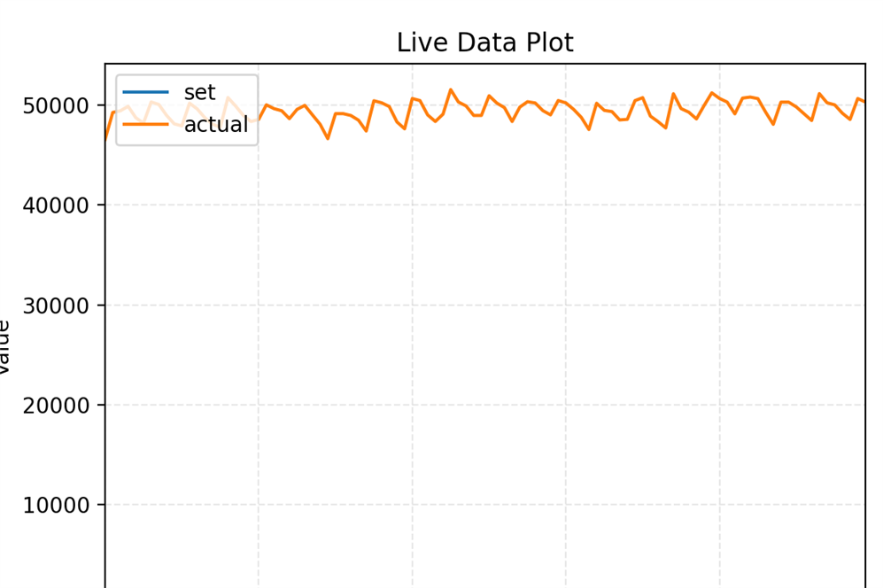

    Jan Cumps over 1 year ago
    Preview of the controller's output. Python charting software courtesy shabaz .
    One of the reasons it's not regulating, is because the duty cycle is inverse of what I was expecting. 0 = 100%. 65000 is 0%. Checking if that's a setting...
    edit: found it:
