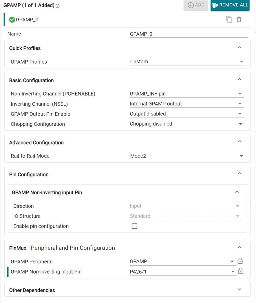

    GPAMP config I used (this needs the blue LED, LED2 removed as you've mentioned in another post, to get access to the non-inverting input):
    The "Mode 2" in the screenshot above indicates rail-to-rail mode (needed since the input is very close to the rail at the lower temperatures).
    The ADC config was then modified to reroute it's input to Channel 14, which is the op-amp (as shown in thre ADC0 Channel Mapping table in your screenshot earlier).
    No application code changes, it was rebuilt and it worked.
    Jan Cumps over 1 year ago in reply to Jan Cumps
    how that GPAMP can be configured:

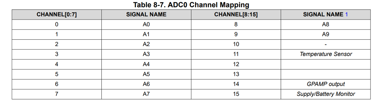

    Jan Cumps over 1 year ago in reply to shabaz
    > The little glitches in the ADC measurements only seem to be from the thermistor measurement
    If the thermistor needs buffering, that's possible. The output of the internal general purpose opamp (GPAMP) can be routed to an ADC channel.
    And if you're looking for a pure buffer, no opamp feedback resistor needed. That can be set in firmware.

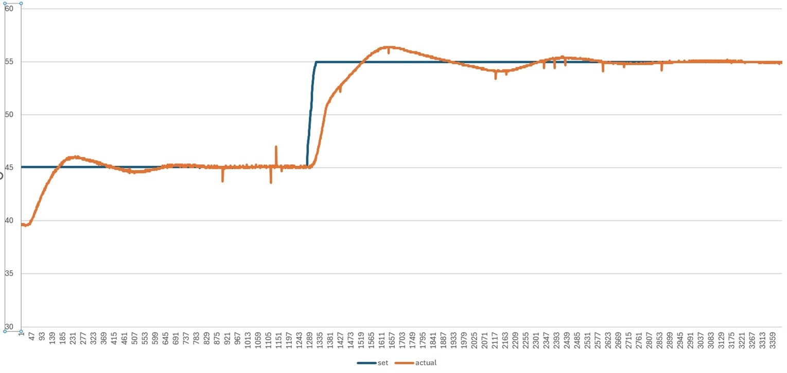

    I added the PWM code and was getting a lot of overshoot which I couldn't seem to correct, plus it seemed to flip between extremes. I tried tuning things by experimenting, but I didn't get far. Eventually I asked chat GPT for help, and it proposed doing something interesting to the PID, namely, only enable the "I" portion when it's within a few degrees of target. Don't know why. Also it made quite a few modifications, to sort out some inconsistencies I had concerning the ranges of values I was expecting to use for the inputs and the PWM range I wanted. I'll tidy up the code and post it, since currently there are two PIDs in parallel, the one where I'd been experimenting, and the one proposed by ChatGPT, and it's confusing until I delete the old one.
    Here's a run of 11 minutes, the initial set temperature was 45 degC, and then I moved the potentiometer to 55 degC. The vertical axis shows the temperature (blue is potentiometer, orange is thermistor), and the horizontal axis shows sample number, but basically it is about 11 minutes 20 seconds across the chart.
    As can be seen from the orange line, there is some oscillation, but it's not more than about 1.5 degrees C, and then it does dampen down. You can see it takes several minutes to dampen down fully, but doesn't seem too bad.
    The little glitches in the ADC measurements only seem to be from the thermistor measurement, not the potentiometer, so I'm not sure what to make of that. Maybe it's just the bad prototyping, and might disappear if it were done properly on a PCB.
    In summary, all the little modules of code all fitted together, and  I think it's all functioning, but I still need to test at a much higher temperature like 150 degC. Plus I need to refresh myself on Excel, and make a more decent chart with time in minutes on the x-axis.
