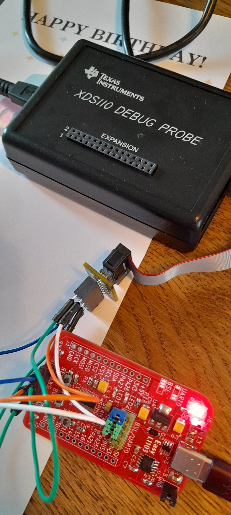

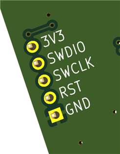

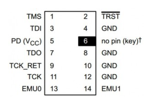

Most TI debuggers have a TI specific 14 pin connector. I used that one, and connected the necessary signals to the debug connector of the kit:
image source: TI forum and EasyL1105: A Dev Board for the TI ARM Cortex-M0+ L-Series
TI 14pin EasyL1105
1 SWDIO/TMS 4 SWDIO
2 TRSTn 2 *RST
5 VTREF (sense) 5 +3V3
8 GND 1 0V
11 SWCLK/TCK  3 SWCLK

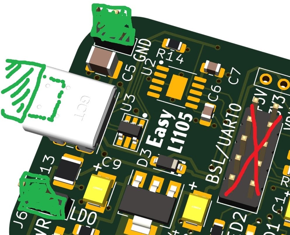

Power for the EasyL1105 comes from its own USB, so mount PWR and GND. In this first test, I don't use the USB data lines. Remove all jumpers from the BLS/UART J3.

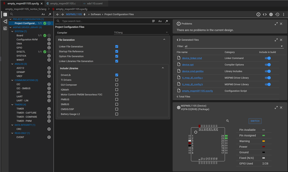

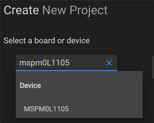

Start ccstudio, and create a new project. Select the mspm0L1105 device:

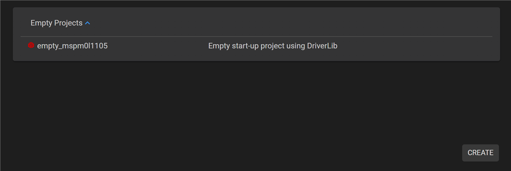

The only available template is the "empty" example. Let's use it.
Press CREATE. ccstudio will now download the MSPM0 SDK for you. When all is done, the project opens in the configurator view:
The controller type is correct. Just change the package to VSSOP-28(DGS28) via the SWITCH button.
We don't need to change anything else. We 'll use GPIO only, and that's already enabled by default in the config.

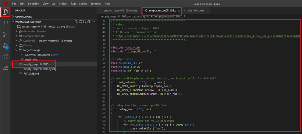

The example does nothing at all. Let's replace its code by shabaz ' demo code for the board. Open empty_mspm0l1105.c.
Replace the content by the kit's example code, available on github. This code is a double! blinky. It 'll blink the two user LEDs.

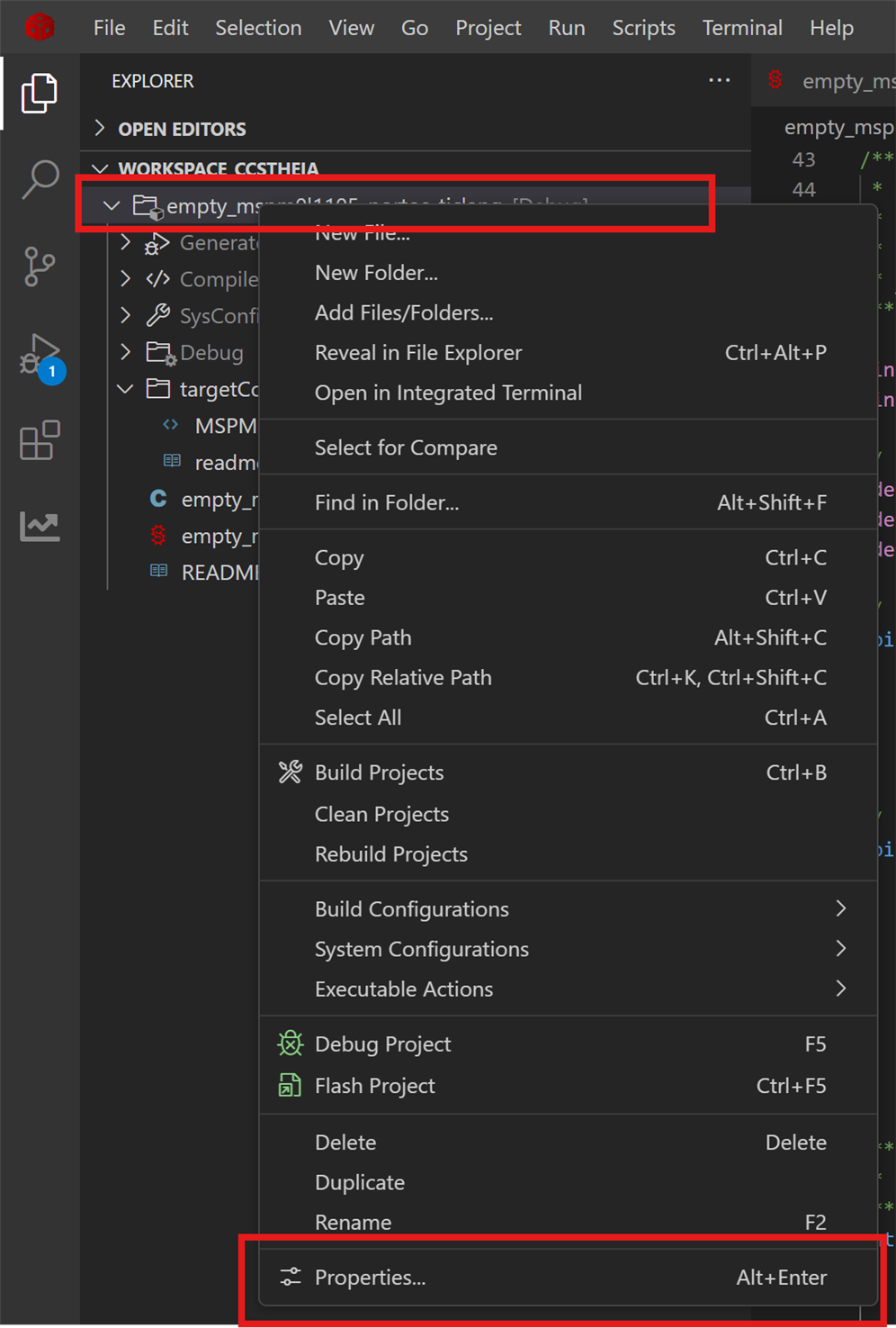

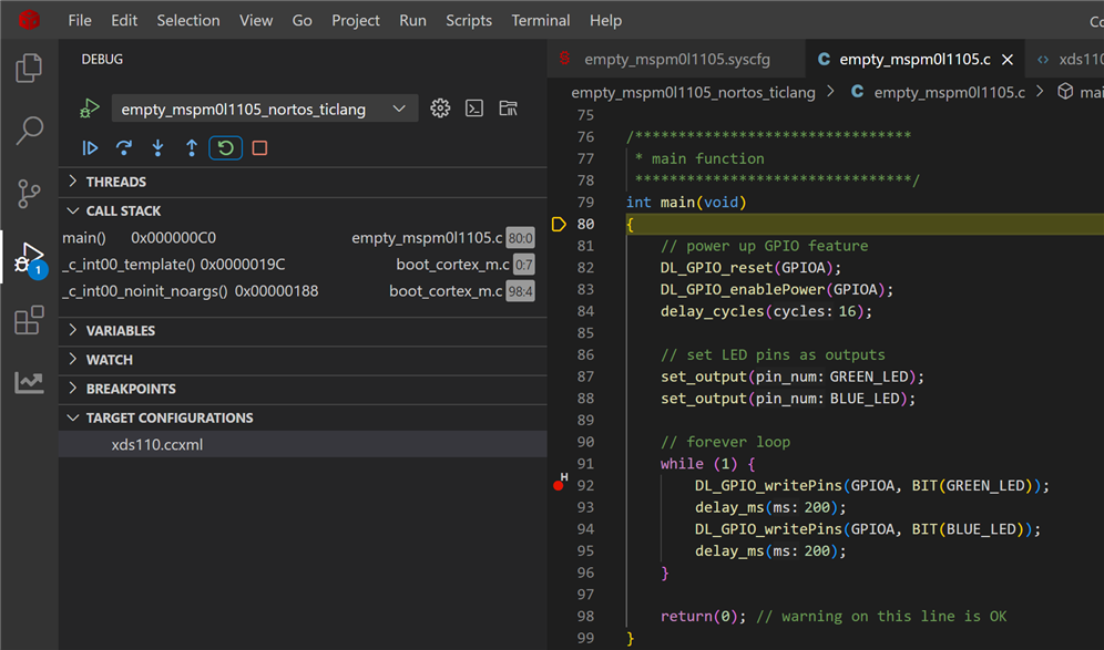

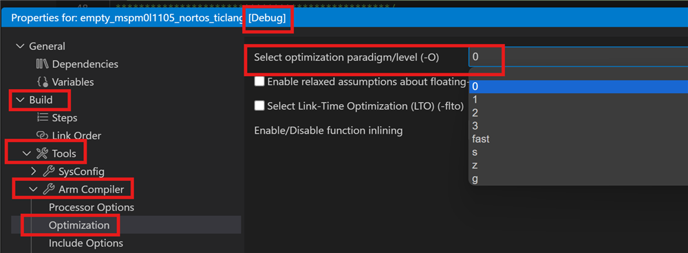

To have the best debug experience, let's tell ccstudio to not optimise our code when using the debug profile. Right click on the project and select Properties
Set Build -> Tools -> Arm Compiler -> Optimization - W level to 0 (default: 2). This will take care that nothing gets optimised, and you can put a breakpoint on every executable line of source code.

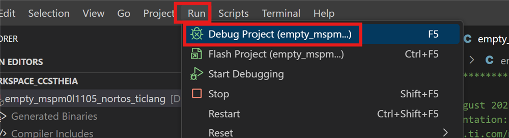

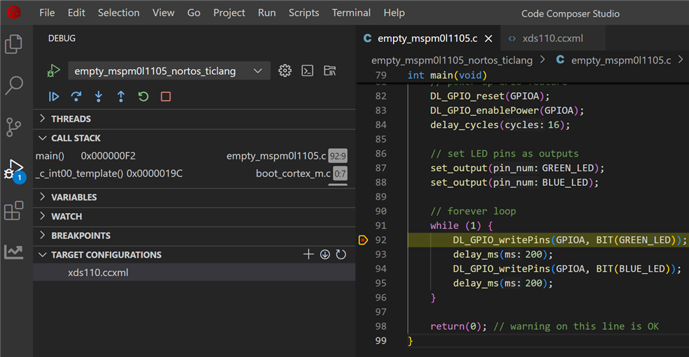

Now start a debug session: Run -> Debug Project
ccstudio will ask you to select what debugger (or dev board) you use. I selected the XDS110. If this is your first debug session with ccstudio v20, it will download new firmware for your debugger, and install it. A little bit later, you are in business:
That's it. Thank you for reading. Alternative: MSPM0 SDK QuickStart Guide for Keil.

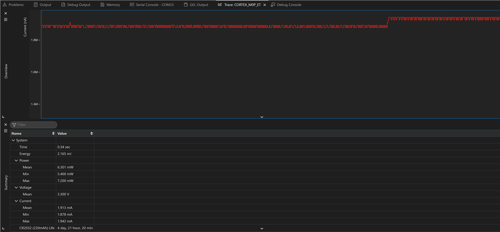

    The XDS110 can provide board power and has a UART - USB bridge.
    There's also a more exciting feature: EnergyTrace:
    This is only available from the XDS110 probe. If you use the XDS110 emulator from a LaunchPad, you don't get the energy trace part. The LaunchPads don't have the circuitry for that.
    The trace above is the EasyL1105 running in normal power mode. Sending data over UART, receiving some date/ There are no low power modes involved. I'm curious to see if I can manage to trace the behaviour in the lower (and sleep) modes ...

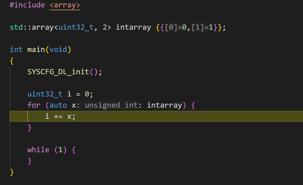

    Me being me Slight smile:
    Running a C++ 26 program with STL container on the EasyL1105:
    side note: the debugger used in the capture above is a LaunchPad:  Cheap debugger ($6) for EasyL1105 MSPM0 board .
