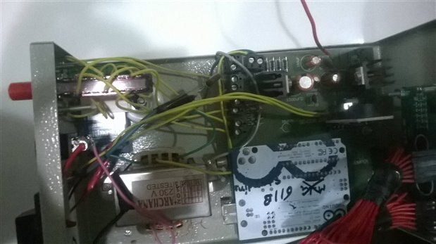

    i am worried about accuracy and reliability.now a day i realize one problem with arduino and that is arduino stop working with out any reason.once i start the power arduino working properly after some interval of time it stop working and work randomly.
  • michaelkellett
    0 michaelkellett over 12 years ago in reply to e14 Contributor
    Can you post a picture of your test set up  - this can often help in understanding 'random' problems.
    MK
    0 e14 Contributor over 12 years ago
  • michaelkellett
    Do you get the same problem with it stopping after a while if you run it somewhere electrically quiet with nothing connected to it ?
    MK
    no i connect sensor with it only.sry if i understood wrong qustion than.
  • alexev
    0 alexev over 12 years ago in reply to e14 Contributor
    Excuse my ignorance, what does that device do? is it a power supply with an lcd or a solder station? My first advice is to test the arduino one as standalone device. Is the supply voltage to arduino stable? (no fluctuations?) What i/o pins do you use on it and are you sure it is programmed ok? Thank you.
    thanx alexev,
      this is one type of speed datalogger.as per sensor output arduino will count rpm(revolution per minute) and store that rpm with date and time in sdcard.i apply 12v dc to arduino which comes from 7812ic.(power regulator)
