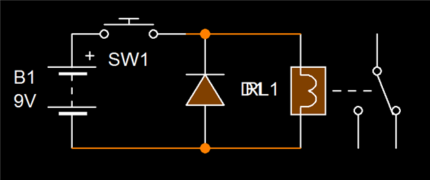

  • supper_slash
    0 supper_slash over 11 years ago
    Here is the setup for the circuit.
    The positive, and negative orientation of the diode is the key.
