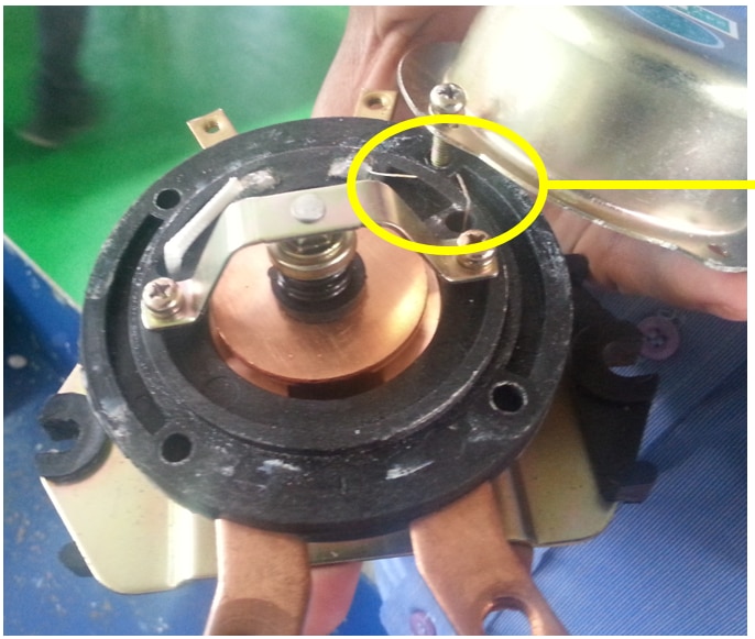

We are using TVS diode across 24V DC-100AMPs relay for automotive application but my relay coil is getting damaged.

    Coil is getting open in between.It is getting damaged near the soldered points.
    Not sure but its a burn out, coil has burn between that.
    Bidirectional TVS is connected across coil.

    I'd suggest carefully pulling apart the relay and examining what is damaged.
    You might want to include some high resolution photos of the damage and teardown.

    That image helps....
    There is no heating apparent from the contact as it seems to be a nice copper colour.
    The coil wire appears to have fused.

    A lot of the cheap versions of these relays are not continuously rated, and will fail in a short time if left energised. They are often for hoist control on recovery trucks etc, where they run for a few minutes only.
    If you are seeing lots of failures, it could be a dodgy batch, or dodgy drive, or incorrect selection. Post a datasheet.
