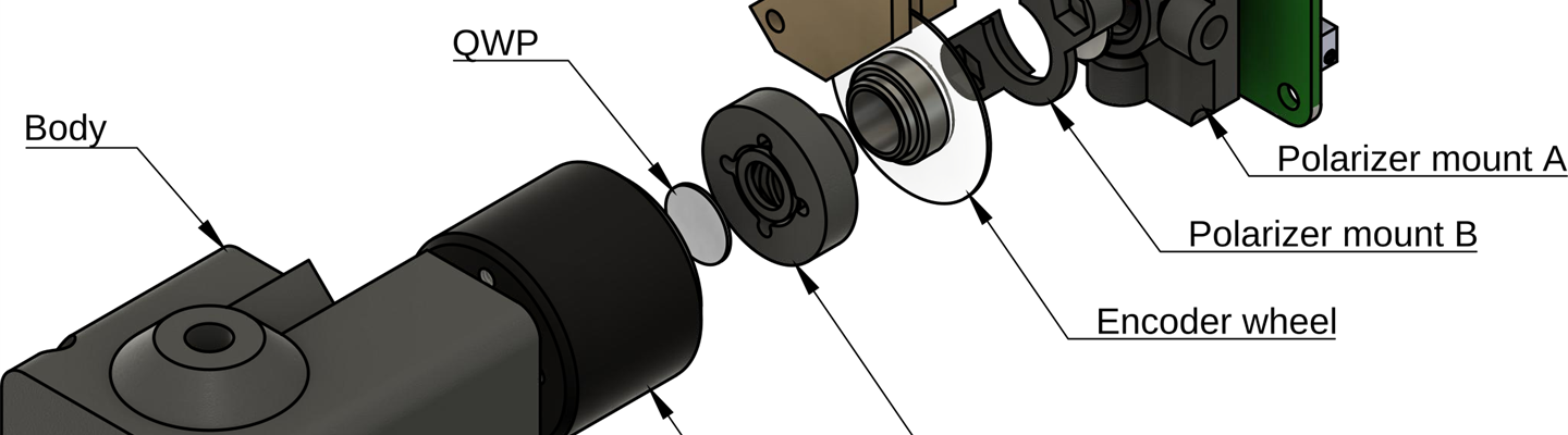

This device consists of two parts the (analog) sensor, where the light gets sampled, and the (digital) electronics. In the middle of the electronics is the Arty S7-25. For analogue to digital conversion, I have used an Analog Devices EVAL-AD7983-PMDZ module connected to the JA PMOD header on the Arty. Since I'm using a brushless dc motor (BLDC), I'll have to use a BLDC motor controller. I have chosen the Mikroelektronika Brushless 7 click along with the Arduino Uno click adapter. The Arduino Uno shield adapter had to be modified such that pins A2-A5 do not connect to the Arty. SCL and SDA on the Arty also had to be connected to A5 and A4 on the adapter respectively. This can be seen in the image, where the yellow and white wires run across the shield adapter.
Hardware - Sensor
As mentioned before, the sensor consists of a QWP and a linear polarizer. At one end there is an amplified photodetector, whose signal is measured by the ADC. To rotate the QWP I'm using a BLDC motor with a hollow shaft (so the light can pass through it). To measure the angle of the QWP, I am using a 3-channel quadrature encoder with 512 counts per revolution. This allows us to "divide" one single revolution into 2048 steps/counts. Usage of a 3-channel quadrature encoder is important so that we can find a "zero" position of a sensor, hence we can find the absolute position/rotation. The encoder is connected to the JC PMOD header on the Arty. The BLDC connects directly to the Brushless 7 click and is supplied with +12V. For more information refer to the GitHub repo mentioned in the introduction.
