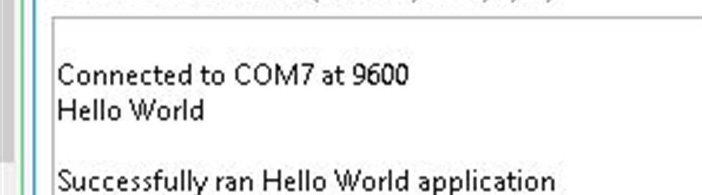

To launch the application on the Arty S7 boards, first make sure that the Arty-S7 board is connected via USB and powered up. Then, right-click <Application Name> -> Debug As -> Launch Hardware (Single Application Debug)
Vitis will switch to Debug view and upload the binaries to the FPGA. Once this is done, the application will halt at the first line of the application's main() function. This is a good opportunity to connect the Serial terminal to the serial port of the Arty-S7, as shown below (Make sure you use the COM port specific to your instance..in my case it was COM7):
Once this is connected, click the Resume icon in the top toolbar:
You should see the following messages in the Serial Console window:
That's it. We have successfuly created and ran the first hello Microblaze application on our Arty S7 board.
