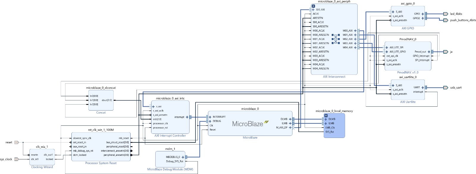

In a little bit more than a year ago I began experimenting with my first FPGA, the Digilent CMOD S7. FPGAs are quite flexible and can be used as programmable logic devices, but also as microcontrollers, since the programmable logic can be used to build a microcontroller. The programmable logic is flexible enough to allow you to design your own microcontroller, but this is would be very time consuming. There are many microcontroller architectures that  are available for FPGAs, but 2 are very popular and well supported by Xilinx: Microblaze and ARM Cortex-M.
So far most webinars that I've seen on Element14 have focused on the high level side of the FPGAs. Since so far I only had experience with the lowest level side of FPGAs (Verilog), I thought it would be a good idea to take the 3 part webinar series to learn a bit about how to build a Microblaze microcontroller and program it to read sensor data from the PmodNAV (A 9-axis motion sensor + barometer PMOD board).
The webinars get you started on how to use an Arty S7 to read sensor data and print the values in the virtual serial port:
Arty-S7 Workshop: Part 1: Learn about Xilinx FPGAs and Embedded Processing
Arty-S7 Workshop: Part 2: Building a Custom Microcontroller in Minutes
Arty-S7 Workshop: Part 3: Rapid Sensor Prototyping with Digilent Peripheral Modules
By the end of the webinars we end up with the following synthesized Microblaze microcontroller:
The designed microcontroller uses the FPGA internal memory, and connects 4 LEDs, 4 push buttons, Digilent's PmodNAV and the virtual serial port. After building the microcontroller, one can program it using Vitis, an Eclipse-based IDE. In the webinar we learned how to use Vitis to program the microcontroller to read the sensor data and continuously print the data to the serial port.
