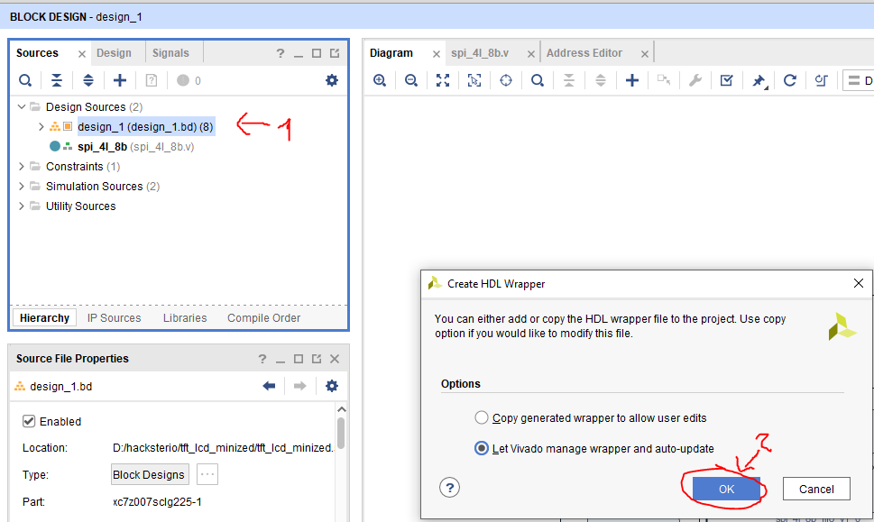

First, we need to create Vivado project:
{gallery}Vivado project creation

Block design
The last step before implementing the design is to connect everything in block design. First, we need a clock source, for this add ZYNQ7 PS IP'core and run block automation.
{gallery}block design
Add SPI modules to block design, by dragging them from sources and other IPs for generating LCD signal and also a VIO for reset control. Minized PS IP FCLK_CLK0 is 50Mhz. LCD module maximum frequency is 10Mhz, so we need to use clocking wizard IP to lower the clock frequency.
{gallery}Block design Ips
Save block design, Vivado should automatically detect and set this block design as a top module. Generate bitstream and program Minized. If you have problems with VIO control, try to lower JTAG frequency. Use VIO to control the reset bit, as reset is active low, set this bit to high and look at the LCD.
{gallery}Program minized
