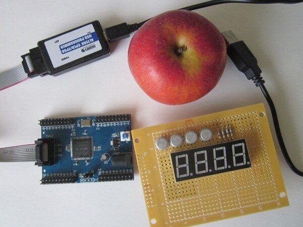

Quick little project to make an egg timer using the MAX II board that I bought over the summer.
Initially, I'll just have it counting down from three minutes. If I feel suitably inspired later, I
might extend it to allow setting the start time, have an alarm go off at the end, and stuff like
that. This is just me having a little fun and hacking some logic together. It won't be very
polished or rigourous, and I won't be bothering with simulation - I'll get it going the same way as
you would with a board full of logic chips, ie use the oscilloscope if I get stuck.
Hardware
I already had a 4-digit 7-segment display (Tru-Opto OSL40562-IY), so I'm using that. That part is
'common anode'. The anodes of the eight LEDs that make up a single digit are connected together and
brought out to a single pin on the package, so the display has four anode drive pins in total. The
cathodes are commoned, so all the 'a' segments share a single pin, all the 'b' segments have a pin,
and so on. There are actually 8 segment pins because each digit also has a decimal point. The
practical consequence of all that is that the display will need to be scanned (the drive signals
for the segments of a particular display digit will be presented whilst the common-anode connection
for the digit we are going to illuminate will be connected to the supply via a PNP transistor, and
the hardware will cycle round all four digits in turn).
I'm doing the connection of the anodes to the supply with some BC461 transistors, with a 1k base
resistor (I found 4 in an old antistatic bag, which was a stroke of luck). I need the transistors
because, if all the segments for a digit are on, the combined current far exceeds what it's
reasonable to take from a single IO pin on the CPLD. The segments I'll drive directly from the CPLD
with a 94R resistor [2x 47R in series] to limit the current to around 10 or 11mA.
This is what the top of the prototype looked like
The apple was a Red Windsor (and very nice it tasted, too).

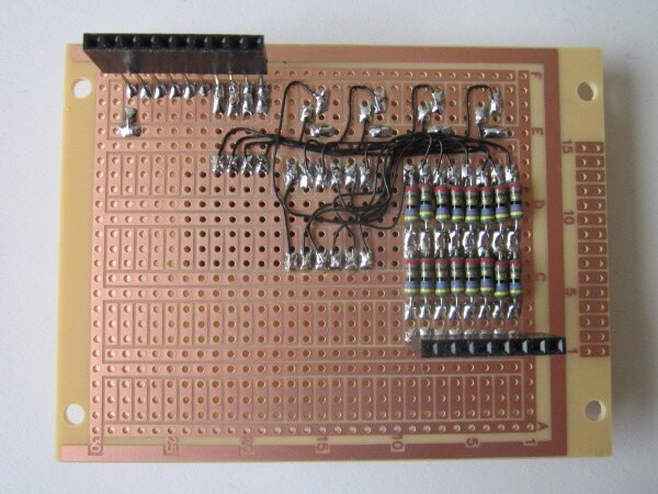

Here's the underside
I simply soldered all the components in place and made the connections with wire-wrap wire.
Later, I added three buttons, which you'll see on the video. The buttons are to ground with a 10k
pull-up to the 3.3V supply.

The design as it stands at the moment uses 101 out of the 240 logic elements of the device (42%),
so plenty of room to elaborate my egg timer if I want to. For any of you not used to programmable
logic, it gives an idea of the kind of complexity you can achieve with even a small, modest CPLD:
probably equivalent to a board full of logic chips, if you were to do it discretely with CMOS or
TTL logic.
Video
Here's a video of the start when I press the left button. The display goes to 3.00 and then counts
down at one second intervals.
I decided to spare you the whole 3 minutes, exciting though it was, so here's the last 15 seconds
before it finishes and sits on zero. This is the revised version with an alarm sounding at the end.
With 10mA for the segment drive, multiplexed that gives an average of only 2.5mA, but the display
is quite visible. In real life, the contrast is much better than it appears on the video, though
obviously it would improve further with a piece of filter material in front of the display. My
decision to go fairly fast with the scanning (250 times a second) paid off with the video - I can't
see any evidence at all of strobing on the pictures.
