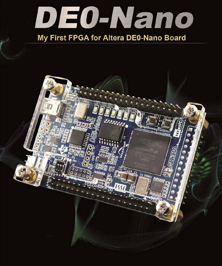

Using The Demonstrations
The demonstrations that come with the Terasic cd are easy to install onto the board (once you have the driver installed!). Simply locate the relevant .bat file while the development board is connected to your pc and it flashes automatically, so all of this seems simple enough and were at the end of the quick start guide. I'll need to look further into the documentation to find out how to make such a mysterious .bat file!

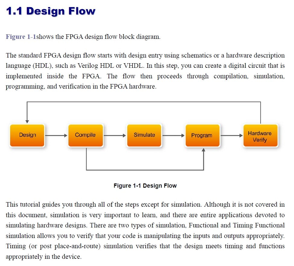

The final part of that guides suggests reading the user manual on the cd to learn more, while looking for that I noticed another file in the same directory called "DE0-Nano_My_First_Fpga_v1.0.pdf" and so decided to take a look at that first. I'm sure glad I did!!
Moving On From The Quick Start Guide
Page 1 of this guide really seems to put me at ease, it just explains the process of FPGA design in a simple to understand way. I suppose part of the difficulty of getting into a technology like FPGA's is the fear of the unknown and the assumption that it's going to be really complicated. To have the process explained in such a simplistic and clear way has taken away a lot of my apprehension.
Page 7 describes what the rest of this guide is all about, its basically a complete step by step guide to making a project with the Quartus2 design suite, it teaches you how to create a counter which displays on the LED's of the development board. Once the project is finished it guides us through the whole compilation process and then shows us how to get this compiled project onto the FPGA development board itself so we can see it in action.
