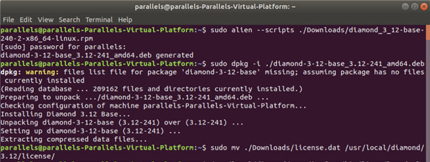

Then point it to the Lattice Diamond software package .rpm for it to convert. Be sure to use the scripts option so that it includes all scripts in the package.
~$ sudo alien --scripts ./Downloads/diamond_3_12-base-240-2-x86_64-linux.rpm
Unless otherwise specified, alien will output the converted Debian package to the ~ home directory, where you can then use the usually dpkg package manager to install it.
~$ sudo dpkg -i ./diamond-3-12-base_3.12-241_amd64.deb

~$ sudo mv ./Downloads/license.dat /usr/local/diamond/3.12/license

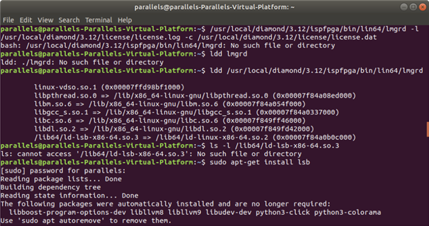

~$ /usr/local/diamond/3.12/ispfpga/bin/lin64/lmgrd -l /usr/local/diamond/3.12/license/license.log -c /usr/local/diamond/3.12/license/license.dat
However, you might get an error like this:
bash: /usr/local/diamond/3.12/ispfpga/bin/lin64/lmgrd: No such file or directory
A bash error thrown by an executable in this context usually means that a dependency is missing. To determine what’s missing, use the LDD command to print the shared library dependencies of the executable throwing the error:
~$ ldd /usr/local/diamond/3.12/ispfpga/bin/lin64/lmgrd
Libraries expected by the executable appear on the left side of the => operator while the corresponding libraries present on the system appear on the right side of the => operator.
The LDD command shows that the lmgrd command called by Lattice Diamond is expecting the Linux Standard Base (LSB) library, but it is currently not present on my Ubuntu machine. So I can resolve this by installing it:
~$ sudo apt-get install lsb
Once the missing dependency is resolved, the license manager should start right up and immediate return the command line back for you to then be able to launch the Lattice Diamond software:

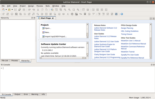

Run Lattice Diamond from the Command Line
The Lattice Diamond software can be launched as either its GUI or just have the tools sourced to run in the background and be called from the command line. To launch source the tools and just have them running as a background task, pass the & symbol at the end of the command like below:
~$ /usr/local/diamond/3.12/bin/lin64/diamond &
Run Lattice Diamond GUI
To launch the GUI itself, simply pass the following command:

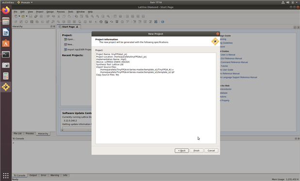

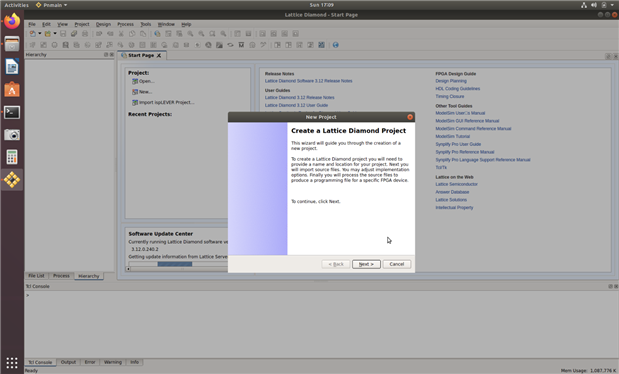

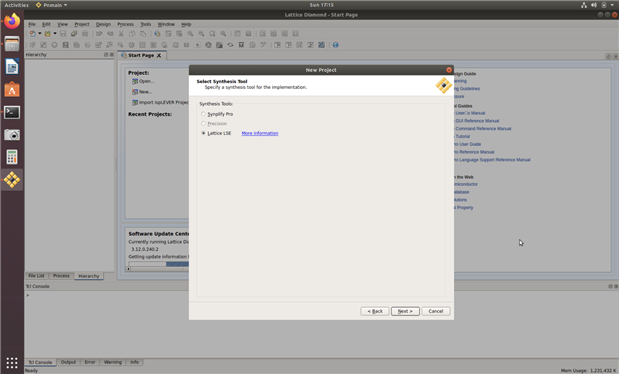

Create New Project

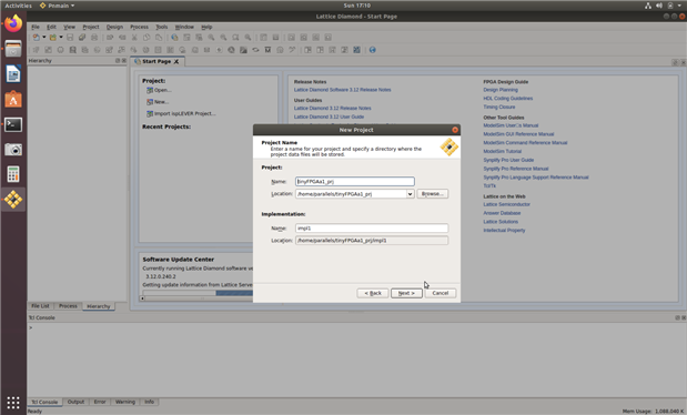

Click the New... option from the Start Page window to create a new project and follow the prompts:
Name the project and select desired file path location:

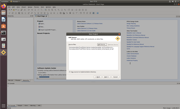

Download the TinyFPGA A1 template files here: https://tinyfpga.com/a-series-guide.html Add the top level Verilog file to the project and the pinout file (.LPF) for the TinyFPGA A1.

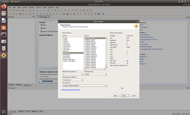

Select the FPGA part number for the TinyFPGA A1 which is MachXO2, LCMXO2-256HC, performance grade 4, QFN32 package type, commercial, LCMXO2-256HC-4SG32C part name.
Select Lattice LSE for the synthesis tool.
Finally, review and verify the project settings information before clicking ‘Finish’.

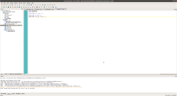

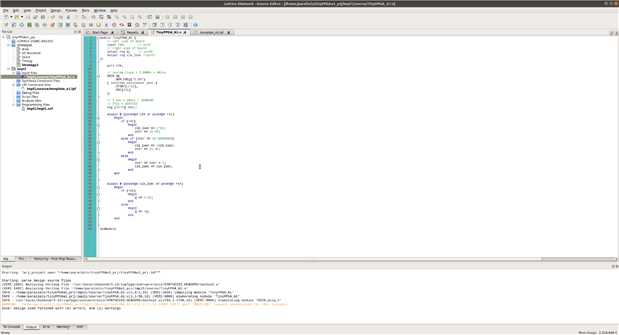

Add the desired code to TinyFPGA Verilog file, TinyFPGA_A1.v, found under the Input Files folder in the File List tab.
If your custom code changes the top level signal names or the number utilized, be sure to also update the pinout constraints file. It is also found in the File List tab in the LPF Constraints Files folder as template_a1.lpf

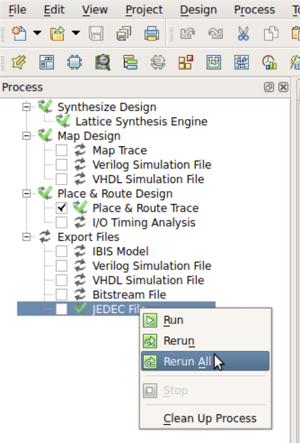

After making the desired modifications, save the top level Verilog file and pinout constraints file then run synthesis, place & route, and generate a bitstream. Switch over to the Process tab, right-click on JEDEC File under Export Files and select Rerun All.

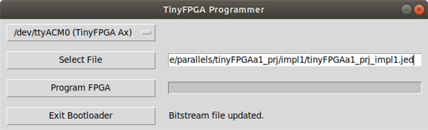

First select the TinyFPGA USB device from the drop down box at the top. Then click the Select File button then navigate to the bitstream file generated in Lattice Diamond, it’ll be located at /<project directory>/impl1/<project_name>.jed
Finally, click Program FPGA and wait for the Success notification text below the status bar. Click Exit Bootloader once done.
