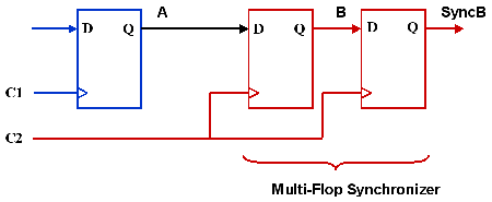

This synchronizer circuit is made of an input flip-flop synchronized in the input clock domain and a set of two flip-flop synchronized in the output clock domain.

Back to our synchronizer problem, the case of the camera and the FPGA having two different clocks and thus two different clock domains.  The problem is that the time evolution of two independents clock domains is not synched by the same time-base. For a D-flip-flop to work the future (D input) must be stable for a given amount of time before the clock-tick (setup time) and while the clock is high (hold time). But when the input of a flip-flop is not in the same clock domain, it’s not possible to guarantee theses timing conditions. The synchronizer circuit is required to minimize the risk of registering an unstable future input into the target clock-domain (more on that in http://www.altera.com/literature/wp/wp-01082-quartus-ii-metastability.pdf).
