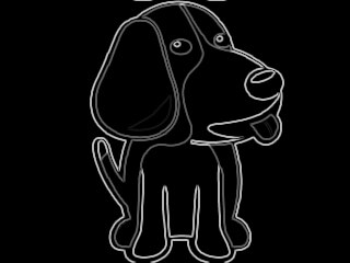

Gradient filters for image processing are kernel based operations that process an array of pixels from an input image to generate a single pixel in an output image. Most gradient filter algorithms use a 3x3 pixel window but some uses a 2x2 pixel window. In this posts we will work on a Sobel based operator to implement the gradient filter. The Sobel kernel is designed to extract the gradient in an image, either over the U axis (along columns) or V axis (along horizontal lines) and the two U/V oriented filters can be combined to extract the gradient direction or the U/V gradient intensity.
Figure 1 : beagleboard.org logo and its gradient intensity, extracted using U/V Sobel filters
Figure 2 : Computing gradient intensity for a small image
Gradient filter is a step for many vision processing tasks like  : edge enhancement, corner extraction, edge detection ...
