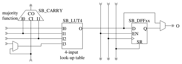

Here is a diagram showing how SB_LUT4, SB_CARRY, and SB_DFFxx combine to make an iCE40 Logic Cell (LC):
SB_LUT4 has four inputs I0-I3 and output O, which can be the logic cell output O and/or the input to a D flip-flop.  SB_DFFxx is a DFF with various clock-enable and set/reset options, which are listed in the iCE Technology Library document.  For example, SB_DFF has EN=1 and no set/reset, SB_DFFR has asynchronous reset, SB_DFFSS has synchronous set, and SB_DFFESR has a clock-enable input and synchronous reset.  There are also versions with inverted clocks.  LC output O is either the LUT output or the DFF state Q, selected by a configurable multiplexer.
Logic cells are stacked into Programmable Logic Blocks (PLBs), each of which has 8 LCs.  The EN and SR signals and clock polarity must be the same for all LCs in a PLB.  (SR options may be different for each LC.)
Each LC also has carry logic for building high-speed adder, subtracters, comparators, binary counters, etc.  SB_CARRY is the majority function, i.e., the carry-out function of a full adder.  SB_LUT4 calculates the sum output of a full adder and similar functions, setting the configurable mux for LUT input I3 to be the carry in (CI) from the LC below this one.  CI may also be 0 or 1 if this is the lowest LC in a PLB.  The carry out (CO) from SB_CARRY goes to the LC above this one.
Arachne-pnr tries to combine SB_LUT4, SB_CARRY, and SB_DFFxx whenever possible.  In some cases, the logic cannot be combined and arachne-pnr uses SB_LUT4 as a "pass-through" for carry in/out or a DFF input.  Combining SB_LUT4 and SB_CARRY requires the SB_CARRY I0, I1, and CI input signals to be the same as the SB_LUT4 I1, I2, and I3 inputs.
Here's a BLIF example from a binary counter.  Given the current state p5 of the counter,  it calculates the next state np5:
.gate SB_LUT4  I0=clr I1=$0 I2=p5 I3=pc5 O=np5  # np5 = next p5
.param LUT_INIT 0000010101010000
.gate SB_DFF  C=clk D=np5 Q=p5
.gate SB_CARRY CI=pc5 I0=$0 I1=p5 CO=pc6        # pc6 = carry to p6
SB_LUT4 calculates np5 given p5 and carry-in pc5 from the next lower bit of the counter.  np5 is clocked into SB_DFF to update p5 at the next rising edge of clk.  SB_CARRY calculates carry-out pc6 for the next higher bit of the counter.  Note that SB_CARRY's I0, I1, and CI inputs match SB_LUT4's I1, I2, and I3.  SB_LUT4 I0 is set to signal clr which synchronously resets the counter, and I1 is not used so I set it to the constant 0.  (Yosys uses $true and $false for 1 and 0, but BLIF lets you define them to be something else.)
SB_LUT4 has a LUT_INIT parameter that specifies the binary truth table for the LUT.  Each bit i (numbered from LSb = 0) is the LUT value if I[3:0] = i.  If I0 = clr = 1, the LUT output np5 is 0.  If I0 = 0, the LUT output is I2⊕I3 = p5⊕pc5.
Arachne-pnr combines SB_LUT4, SB_DFFxx, and SB_CARRY into an ICESTORM_LC, which includes parameters for DFF and carry chain options.  You can see how it did this using the "-B" option.  I think arachne-pnr understands ICESTORM_LC blocks in its BLIF input if you want to combine LUTs, DFFs, and carry logic yourself before running arachne-pnr.
