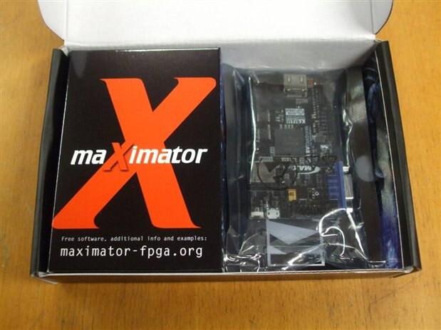

I did find the MAXimator board and bought one - it arrived quickly and without any problems, cost was £58.15 (actually billed to credit card so includes a bit for the euro to £ conversion). They have  web site: maXimator - Altera MAX10 FPGA development board
It looks like this when it arrives:

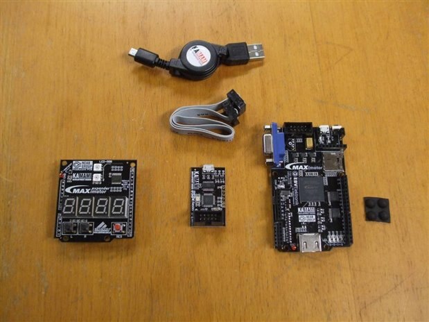

The bits you get are:
That's a MAXimator board, a plug in board with the display, a couple of buttons and two multi colour LEDs, a separate "Blaster" (Altera USB programmers are known as Blasters for some bizarre historical reason) and  a couple of leads.
The web site has a schematic, a nice colour pin out chart thing and a user manual. Enough documents to get going. The MAXimator has a slightly odd set of on board  connectors:
An Arduino compatible set of IO with 3.3V to 5V conversion - so its truly Arduino shield compatible.
It also has VGA and HDMI connectors - these are intended to be driven by the FPGA so serious code is needed to make them do anything useful. There is a micro SD socket as well. The VGA connection doesn't have DACs so the range of colours isn't going to be great (8 including black). If you can code it the HDMI is digital so not restricted. The only pins available for the user are those on the Arduino headers - this isn't very many and the lack of free IO pins will limit the use of the board - the Altera board does much better in this respect but of course it doesn't have the application specific connectors.
