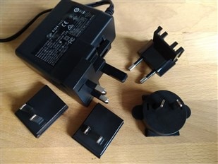

A small point to note is that the 12V 3A power supply that comes as part of the accessory kit has plenty of adapters (5) so that it should work in most countries. Other devices I've tested were limited to US/EU and meant I needed a clunky adapter to use them in the UK. Including these adapters may be a small detail but a nice one.

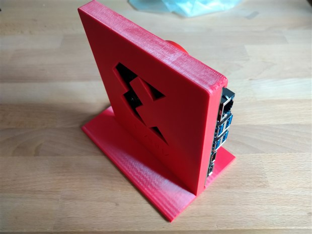

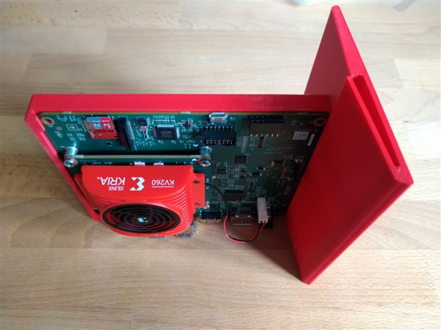

Xilinx also supplied a very neatly 3D printed adapter to hold the board. (It even matches the red fan shroud on the Kria module.) I can see that this might be useful if you had a PCB-mounted MIPI camera but when using the Kria with a webcam it wasn't entirely necessary - the Kira carrier board has little rubber feet so it sits nicely on the desk. I almost didn't mention it - especially as I don't think the kit normally comes with one - but someone has obviously spent a while on this. The base has even been designed to flex so that the carrier board is held firmly but can be released easily.

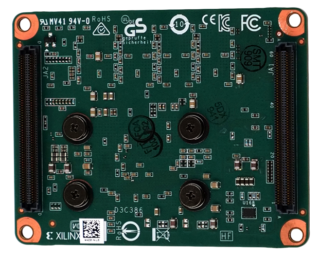

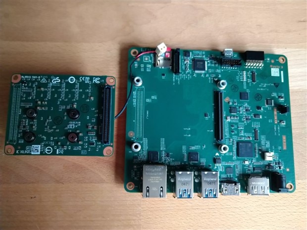

Finally, on to the bones of the kit - the SoM (System on Module) and a carrier board that helps you connect it to the real world. The 2 devices came connected out of the box, but I decided it would be more interesting to see the Kria KV260 SoM and its carrier board separately, so I removed the SoM from the board before taking a photo. Interestingly, both the SoM and the carrier board only have one of the 240-pin connectors populated, despite photos of the Commercial and Industrial SoMs on Xilinx's website showing both headers populated.
Whilst this might seem odd, this is all down to how these devices are intended to be used. The "end goal" for customers using Kira SoMs is for the customer to create their own carrier board with the required connectors and to purchases either the Commercial or Industrial SoMs to go on these boards. Having a pre-built SoM should greatly simplify production of a device and reduce the time to market. The starter kit is intended to be a way to evaluate the SoM and quickly provide connectivity to the sort of peripherals that are likely to be used. The SoM supplied with the starter kit is listed as a "non-production" version. It's not intended to be the final device in a commercial solution. In fact at $199 the Starter Kit including SoM is cheaper than just a production SoM on its own ($250 for the Commerical and $350 for the Industrial version). Whilst the Starter Kit is obviously intended for evaluation rather than production use, I have no doubts about its quality or suitability for use in non-commercial projects. The details of exactly what the difference between the production and non-production SoMs, I've managed to glean a little more information.
  • The non-production SoM has only one connector
  • The production SoMs have 16GB of on-board eMMC storage, allowing applications to be booted entirely on the SoM. The non-production SoM must use external microSD storage on the carrier.
  • The production SoMs have a larger temperature range.

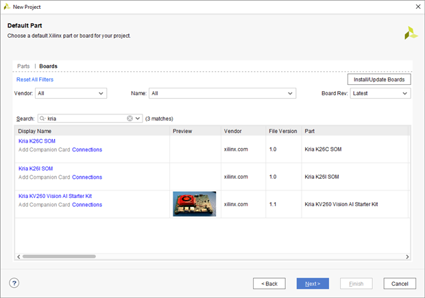

Whilst the KV260 starter kit is designed that you don't need to delve into Vivado and Vitis to make use of powerful vision applications, this is of course supported. I made sure that I had Vivado 2020.2 installed before receiving the board and decided to at least try to create a simple project for the device. It's worth noting that the device on board the SoM is unique to the Kria. The XCK26-SFVC784-2LV-C part is not available elsewhere, although it is similar to other Zynq Ultrascale+ parts. As I said, I had 2020.2 installed. I hadn't seen any need to do the huge (14GB) minor version update to 2020.2.2. According to the release notes, the update seemed to include a few more devices but there was no mention of the Kria part. When connecting the starter kit to my PC and running Vvado's hardware manager I could see the device but couldn't do much with it.
As part of a Kria webinar, it was suggested that the following TCL command in Vivado would create a project for the new part, although I was just presented with "part not found"
create_project -part XCK26-SFVC784-2LV-C MyKriaProject
I decided it was worth trying an update to 2020.2.2 and that seemed to do the trick! It then dawned on me that the point release had come out in February - when the Kria was still top secret. Now it was possible not only to create a project manually but even to select the part or board when creating a new project using the GUI. Much better!
