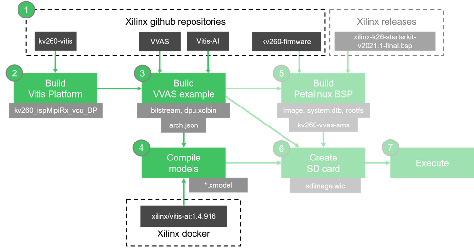

This part of the tutorial will re-compile the sixteen (16) supported models used by the smart_model_select application for our targeted DPU architecture (B3136).

In order to facilitate the model compilation process, we will use the following script:
  • https://github.com/Avnet/vitis/blob/2021.1/app/zoo/compile_modelzoo.sh
This script will automatically scan the model-list directory, interpret each model.yaml file, and compile the model accordingly.  A lot of time went into the creation of this compilation script, and will save considerable time during the model compilation process.

Xilinx provides a docker container with contains the tools required for model compilation.  Launch the vitis-AI 1.4 docker container as follows:
$ cd $PROJ_DIR/Vitis-AI
$ ./docker_run.sh xilinx/vitis-ai:1.4.916
Launch compilation script
> cd models/AI-Model-Zoo
> source ./compile_modelzoo.sh
> exit
Notice during compilation that the DPU architecture is reported as DPUCZDX8G_ISA0_B3136_MAX_BG2.
Models will be in the following location
Vitis-AI/models/AI-Model-Zoo/models.b3136
