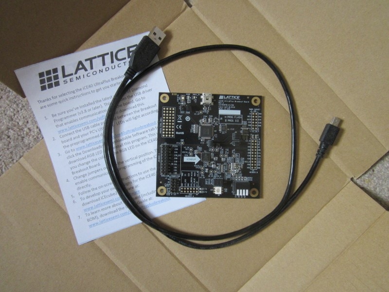

What you get
The evaluation board came in a plain cardboard box, wrapped in an antistatic bag which I now seem to have lost. You also get a USB cable and a single, printed sheet that acts as a quick-start guide to finding the design software and other documentation online. The box was folded and taped shut along the top, so, once you've opened it, it no longer functions as a storage box.

The board is fairly minimalist and, in addition to the FPGA, carries a USB port, an FTDI chip for the device programming, a crystal oscillator (12MHz for the FTDI USB, which can also be routed to the FPGA as a clock), a serial flash memory for the bitstream, and linear regulators for the IO and core power. The board is a reasonable size (3" square), has sensibly-sized mounting holes at each corner, and has unpopulated placements for headers to bring out all the spare I/O. One of the headers is arranged as a PMOD interface, so populating that one would allow access to a wide range of IO boards. Given the price of the board, I thought it a little mean not to populate the headers (my Lattice Brevia 2 board came with the headers installed).
The worst thing about what was otherwise a neat and tidy board was that the one I received had the header holes full of solder. Getting solder out of the pin holes that were connected to the ground and power planes, using a hand solder-sucker, was painful.
Although I said the part itself was good value, whether the board is will depend on your situation. For a company, it probably represents less than an hour of design engineer time, and is the safe and quick way to evaluate the part if you aren't confident enough to go for an immediate prototype board: you can be reasonably sure it will function with their design tools and programming software. For a personal project, there will be lower cost options out there.

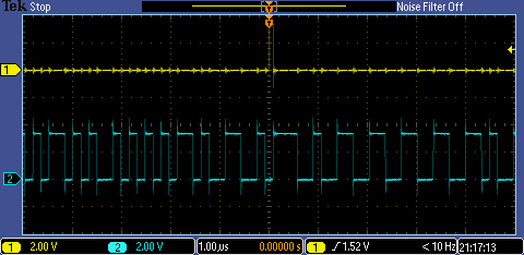

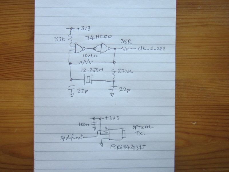

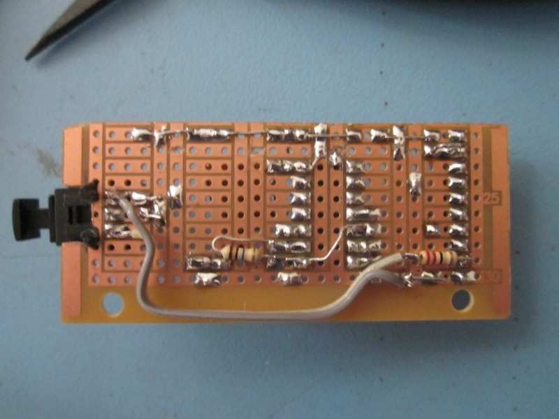

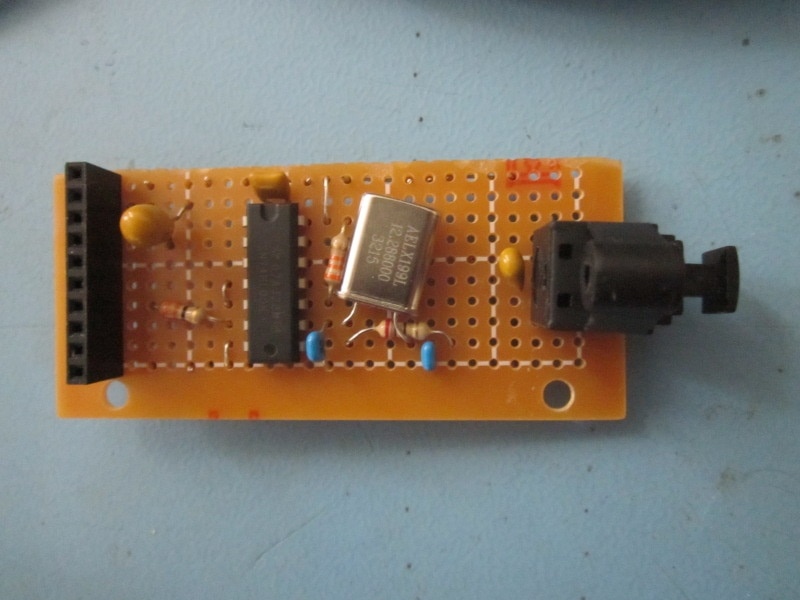

For a simple project, I'm going to connect an audio fibre-optic transmitter to the board and send out a pair of sine waves calculated with the CORDIC component that I previously developed on an XP2 Brevia board. On the output side, this is basically PCM S/PDIF running over TOSlink. Porting the CORDIC component from XP2 to iCE40UP5K is easy: I just include it as a component in the new code and set the resolution generic appropriately - in this case to 16 bits (CD quality! Approximately. If I'm lucky and get it right). This will require me to develop a simple S/PDIF component for the output side. It's slightly artificial, and a bit limited unless you need a test box with only one, fixed function, but seems a reasonable amount of effort for a review and it could easily be developed further to be more useful. It also takes me a further step on towards doing some electronic music, which can't be a bad thing.
The hardware is fairly simple. The optical transmitter part works on 3.3V and can be driven by a single IO pin from the FPGA. Easy-peasy! As with the last couple of XP2 blogs, I'll also need an appropriate clock to derive the audio sample rate, so I've reused the xtal oscillator circuit I used there, with a logic gate for the gain element and a somewhat better choice of components than I used before around the 12.288MHz crystal.
Here it is wired on a small prototyping board.

A couple of things about the SPDIF component may not be totally obvious.
The standard allows for the preambles to be inverted (in order to deal with a balanced link where the two sides are swapped). That's relevant for a receiver, which must be able to identify either sense, but for my transmitter I can simply choose one or other group.
Overall, the frame data is Manchester encoded, except for the preamble. That exception is deliberate in the design of the standard: the preamble breaks the encoding, so that's the way the receiver is sure that it's finding the boundaries and isn't being misled by a pattern occuring in the regular data. That makes the generation of the bitstream a little fiddly. The preamble can't go in the shift register with the frame data - instead I give it its own shift register and have a mux at the end to select between preamble and encoded frame data.
Further there's the issue of how to deal with the parity bit. I could have kept track of the parity and inserted it at the approprate time in place of the shift register data, but here I've done it a slightly different way. The effect of the parity bit (with encoding) is to bring the state of the output to the same point at the end of each frame, ready for the same polarity of preamble each time. That means we can use the final state of the encoded data stream, immediately before the parity bit, to determine which one of the two patterns that has to be output to get us to that frame end point (in effect, the Manchester encoding is working out the parity as it goes along for us and we just need to finish off the sequence). So the mux on the end expands to select either preamble, encoded data, or parity.
Although I started to implement the additional, slower-rate control and data bitstreams, I thought I'd give it a go without, in the hope the receiver could sort itself out from the bitstream alone.
Results
It works! (Sort of.)
Here is the test output (a pulse marking the start of the frame that gives me something sensible to trigger on), and the SPDIF waveform around that point

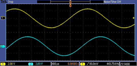

Here are waveforms from the analogue outputs of the fibre-to-analogue box.
Because I've generated two sine waves, one on each channel, that are slightly different frequencies (one is 440.0Hz and the other 440.5Hz), if I trigger an oscilloscope on one, the other will run slowly past it, and the two will align every two seconds [reciprocal of 0.5Hz]. Here's a short video showing that happening.
So why 'sort of'?
The oscilloscope is having a real job trying to trigger on what is supposed to be a very simple, smooth, and precise waveform (a sine wave). Even with the trigger's HF Reject selected, it sometimes triggers on the wrong edge. That's because of all the noise. Here's a close up of what it's doing as it goes through the trigger point.
For what is supposed to be 16-bit audio it's pretty bad (that I can see it so obviously on the oscilloscope suggests it's not merely the DAC in the box dithering the lowest few bits). At the moment I've got no idea why, though it's suspiciously digital looking. It might be my CORDIC component, though the only change I made was reducing the resolution to 16 bits; it might be the SPDIF I'm generating - without the control stream the box may be misinterpreting it; it might be the optical link; or it might be to do with the way I'm looking at the signals with the oscilloscope.
Plenty of choice there for further investigation. Anyway, be cautious about using any of this in its current form. I'll update the blog when I finally sort it out.

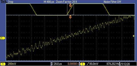

I'm coming round to the idea that the noise is coming from the fibre-to-analogue box and there just isn't much attempt, if any, to filter the (mostly out-of-band) noise coming from DAC. [The DAC in the box will be a multi-level delta-sigma running on my samples, but upsampled to move much of the noise about 20kHz.]
This is the sinewave as it comes out of that box
this is what I see if I pass that signal through a mixer
The mixer will have some light, low-pass filtering right at the input, to reduce the effect of RF getting into the signal chain and producing intermodulation products in the active components, and that seems to be enough to dramatically reduce the noise.
You can see above that there's still some there, but then the filtering in the mixer won't be tight in to 20kHz, because the designer has to make some assumptions about what's reasonable for the source impedance driving it, and it won't roll-off aggressively either (probably only an RC filter).
Perhaps the designer of the box took the view that if you can't hear it, it doesn't matter. It was quite cheap.
Conclusions
