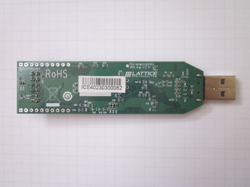

A good while back, when I purchased an ADALM1000, I realised that Farnell had the Lattice
ICEstick back in stock so I bought one of those too. I thought it would be nice to do a simple
project, with a few of my impressions of the board thrown in along the way for good measure;
so a sort of informal review.

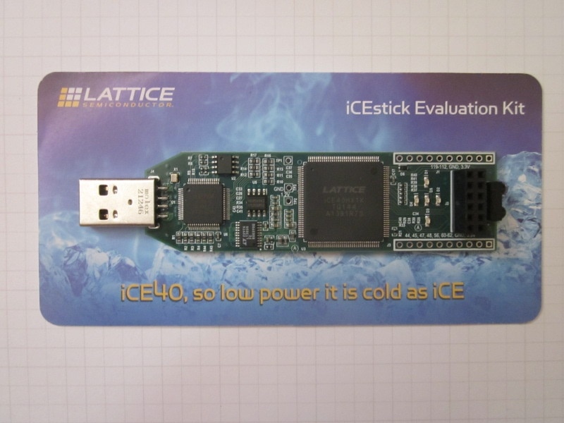

What is the iCEstick?
The iCEstick is an EVB (Evaluation Board) for one of Lattice's range of iCE FPGAs, namely the
iCE40HX1K. It has a device programmer on the board - so no need for a separate programmer -
and it can be plugged directly into a USB port: very convenient if you want to use it with a
laptop or a desktop PC to quickly try something, but maybe a little awkward once you get to
the stage of connecting prototype circuitry to it, though there's no reason it couldn't be run
on an extender cable. When these were first introduced, the price was very reasonable (~£20),
but now they're getting increasingly expensive. Farnell currently list them for £122.78
(ouch!).
The ICE40HX1K device on the board is a small FPGA by modern standards. The 1K stands for the
approximate number (actually 1280) of LEs (Logic Elements), where each LE contains both a
single 4-input look-up table, which can implement combinatorial logic, and a single D-type
flip-flop, which gives the memory element. The intended use would be logic replacement, or
fairly simple interfacing and control alongside a small processor. In terms of scale, it's
fine for learning the principles of how to design programmable logic, and how to develop with
either Verilog or VHDL, but will quickly run out of capability with more complex projects.

Of course, the big 'selling point' is there on the packaging: ice cold! By (older) FPGA
standards, they're low power.

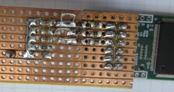

To try out the EVB I'm going to see if I can get it to produce some three-phase waveforms (so
three sine waves, each offset in phase by 120 degrees), at mains frequency (50Hz or 60Hz), by
look-up from block RAMS set up as ROMs (one for each phase), with delta-sigma DACs to do the
conversions (technically, I probably should call them 'modulators', as it only really becomes
a DAC once you integrate the output). The low-pass output filter is 3.2k, with 100nF to ground
(3.2k because I couldn't find any 3.3k SMD resistors and had to make it from a 1k in series
with a 2.2k).

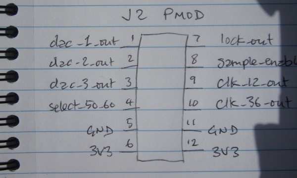

entity ice40hx1kevn_test is port(
    clk_12:            in std_logic;          --- system clock in (from 12 MHz oscillator)
    select_50_60:      in std_logic;          --- freq select: 0=60Hz, 1=50Hz
    lock_out:          out std_logic;         --- PLL lock signal (test)
    sample_enable_out: out std_logic;         --- sample enable (test)
    clk_12_out:        out std_logic;         --- input clock out (test)
    clk_36_out:        out std_logic;         --- PLL output clock (test)
    dac_1_out:         out std_logic;         --- dac 1
    dac_2_out:         out std_logic;         --- dac 2
    dac_3_out:         out std_logic);        --- dac 3

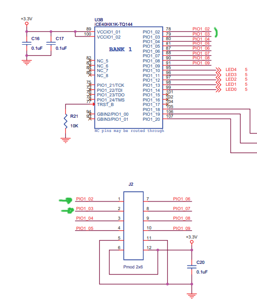

I'm going to bring out all the top-level entity port pins, except for the clock, to the PMOD
connector on the board. Here's the relevant part of the schematic from the user guide.
If I choose pins 1, 2, and 3 on the PMOD connector (J2), I can see that they connect to pins
78, 79, and 80 on the FPGA itself. It's those FPGA pin numbers that I'll need for the
constraints for the place and route. If I don't constrain the outputs to be particular pin
numbers, the design software will just allocate the pins for itself as it thinks best. I'll
also need a constraint for the clock input, to make sure that it comes from the existing on-
board xtal oscillator (12MHz, shared with the FTDI USB chip) on pin 21.
To do this, there's a simple pin editor, on the tool bar, that presents a table of the pins
found in the design and allows the pin numbers to be set. Each pin can be locked if desired.
That leads to this arrangement on the connector itself, viewed from the top. Pin one can be identified by the square pad on the underside of the board. Be cautious of the silkscreen on the top - none of it relates to the PMOD, it's all labelling for the rows of pins along the two board edges.
And, here's the board that I implemented the output filters on. Be aware that the dac outputs may radiate nicely given the chance. When I first tested, without the filter, it wiped out an FM radio a couple of metres away when a scope probe was used to look at one of the outputs. Presumably the signal was driving the outside of the probe cable screen.

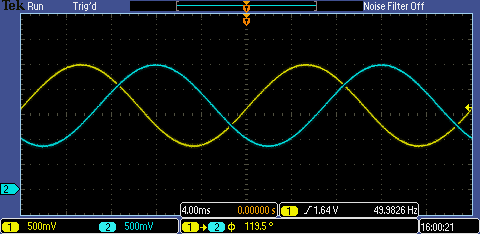

Now that I know I've got a working clock, we can move to the sinewaves, 50Hz first. I only
have a 2-channel oscilloscope, so the first trace shows 1 and 2 and the second trace shows 1
and 3 (yellow is output one in each case).
Here's the last one again, with the frequency switched to 60Hz.

The EVB
- convenient having the programmer on-board
- no frills: just FPGA, programmer, config memory, and clock osc
- I don't think anyone, anywhere, would now say it's 'value for money'
- very limited on the IO side. The 144 pin QFP part has lots of pins - very few of them make
it to the connectors

    Here are two of the output waveforms in higher resolution than my 8-bit Tek scope can manage.
    Quite nice looking sine waves, though if we look at it in the spectrum view there are enough harmonics present for a THD figure of about 0.6%.
    The resolution of the PicoScope is good enough to show me some intriguing, regular sidebands around the fundamental at 50Hz.
    This next spectrum view, over a wider span, is also interesting because it shows some output aliasing at multiples of my sample rate (12kbps). Although they're fairly well down, the simple RC filter hasn't totally wiped them out.
