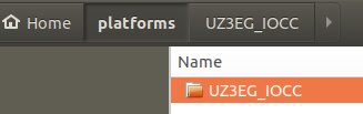

The first step is to have a place to keep all of our platforms.  I suggest creating a folder ~/platforms or leveraging the platform_repo folder created when running the Avnet Vitis make scripting
You can also
    • download the platforms and extract them to a folder (if you get them from someone else)
    • copy from your /vitis/platform_repo BUILD folder (if you use the Avnet build scripting)
    • even just USE the output folder from your platform generation!
The way the Avnet build scripts work, all platforms default to /vitis/platform_repo for easy use by customers as well as leveraging that repository for your own builds!

Here I have extracted the UltraZed-EG IOCC platform into my platforms repository.

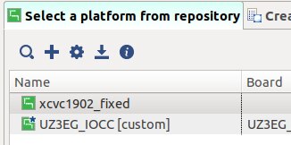

The first way to work with the platforms, is using the GUI:
Create a new Application Project...
Fill in the Project name
Click Next, THEN click the +
Navigate to your folder where you extracted the platform folder and now all platforms that you have on your system will show up!

Those 3 commands work really well to get you a basic setup.  However, in your build environment, if you are using a shared drive full of platforms to choose from, you might not want to click through the GUI over and over.  A quick and easy way to DEFAULT Vitis to a specific folder is to use the PLATFORM_REPO_PATHS environment variable.
For example, setting this variable like this:
export PLATFORM_REPO_PATHS=/home/training/platforms
will actually default the GUI to always include platforms that are located in that folder!  This would be the same as CLICKING all of the above steps in the GUI each time, except the tool does this each time it is loaded.  As this is Linux, you could point this to any number of servers/shares/cloud drives, etc...as long as it is mapped to a folder and you have permissions to point to it.  NOTE, for performance reasons, I suggest that this is a local folder or at the very least a HIGH speed link.  In my testing, OVERALL my largest build machines end up taking  the most time on IO access so anything to reduce this helps!
