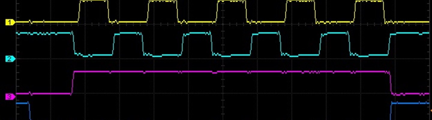

Continuation of  Learning AMD Zynq: a project to generate a set of PWM signals. 1 - problem statement and possible approach .
 yepe has a goal to create a set of signals for an ultrasone pulse generator.
Status after Post 1
In Post 1, we got the PWM and PWMN signals, and a first stab at the PULSE signal. Let's start at that stable point here, and try to add
  • the initial delay between PRF falling edge and the start of the pulse train
  • a PULSE signal that starts and ends exactly when the pulse train starts and ends.
Here's the design from the 1st blog:
The clocking wizard generates a 320 MHz clock. High enough to give the PWM signal a decent granularity for the dead times (2.5 ns steps).
The PWM generator generates 2 complementary signals, PWM and PWMN, with configurable deadband.
The PWM generator has an enable pin. When that pin is low, it will set PWM low and PWMN high, else it outputs the train of pulses
image image
Goal of this post:
  • Build a control block that will tell the PWM when to generate pulses (control its enable)
  • let that block also control the PULSE signal
  • establish the configurable? delay at the start
  • maybe handle PRF?
What this session will not do: handle GATE
Same as in post 1, the action will be in the comments. It's a collaborative exercise.

warning: the train length should always result in full PWM cycles. If you disable the PWM module before it had the chance to generate a full cycle, both PWM and PWMN will switch at the same time and not respect the deadband.

Scope capture (PWM, PWMN, PULSE, PRF)
0 dead time:
2 dead time:
Compare to requirement:
Example with longer initial delay and a longer pulse train, 5 pulses of dead band. The FPGA design is the same. This is done by writing different values to the registers:
Study of the edges. You see the PWM and PULSE signal, 0 dead band.
A few example settings that generate complete pulses. The first two generate 2 pulses, with a short start delay. The second 2 have a longer start delay and generate 5 pulses. The last one is retriggered in a software loop. I've also played with the deadbands.
Vivado project and Jupyter notebook are attached. They are for version 2022.1 and PYNQ-Z2 board
