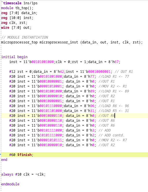

Hii all,
This is me first time posting here on element14. I recently completed a Hardware Description of a part of a processor in Verilog. In this mini project, I ensured the datapaths, added 7 registers ( 6 normal and 1 special). The special register consists of two registers and a conditional adder block, so you can choose to perform addition/subtraction. For demonstration purposes, I did not make any program counter and machine state counter for the sake of simplicity. I have directly feeded the instructions to the microprocessor from the testbench.
Every instruction is of 11 bits, again for ease of interpretation, I did not encode the control bits in instruction. You can go ahead and decrease the length of instruction to 8-9 bits by putting a suitable decoder. Here is how each instruction is interpreted:
- bits instr[2:0] : Register Address 2
- bits instr[5:3] : Register Address 1
- inst[6] : if u want load a register (1 if loading is enabled else 0)
- inst[7] : f u want output to be connected to bus (1 if connected to bus else 0)
- inst[8] : if u want input to be connected to bus (1 if connected to bus else 0)
- inst[9] : choice of addition(0)/subtraction(1)
- inst[10] : loading the special register_adder block, for the first loading this bit should be 0, the next time you load it this bit should be 1
In the attached screenshot, read the instructions versus the comments written beside them
Here are the control instructions:
Here is the output:
There could be several continuations to this project:
(i) If we want to make the writing of the test bench easier, we can write a python script to write the testbench from the assembly level instructions. eg, if we input MOV R2 <- R1, it should generate the following line:  inst = 11'b00001010001; data_in = 8'h0;
(ii) To make a full RISC-V based processor, we will need to code the memory blocks, the Program counter and machine state blocks, this could be a very nice continuation from here.
I am attaching the whole code, where I have dumped all the modules along with the testbenches for you to run directly in Vivado/any other simulator. I highly recommend using Vivado as its extremely robust and stable.
Feel free to hit me up for any clarifications or if you want to share any cool ideas. Also like and comment...show some love (my first post here)

`timescale 1ns/1ps
module tb_top();
reg [7:0] data_in;
reg [10:0] inst;
reg clk, rst;
wire [7:0] out;
// MODULE INSTANTIATION
microprocessor_top microprocessor_inst (data_in, out, inst, clk, rst);
initial begin
    inst = 11'b00101001000;clk = 0;rst = 1;data_in = 8'h67;
    #12 rst = 0;data_in = 8'h42;inst = 11'b00010000001; // OUT R1
    #20 inst = 11'b00101001000;data_in = 8'h77; //LOAD R1 <- 77
    #20 inst = 11'b00010000001; data_in = 8'h0; //OUT R1
    #20 inst = 11'b00001010001; data_in = 8'h0; //MOV R2 <- R1
    #20 inst = 11'b00101001000;data_in = 8'h89; //LOAD R1 <- 89
    #20 inst = 11'b00010000010; data_in = 8'h0; //OUT R2
    #20 inst = 11'b00101110000;data_in = 8'h96; //LOAD R6 <- 96
    #20 inst = 11'b00101101000;data_in = 8'h31; //LOAD R5 <- 31
    #20 inst = 11'b00010000110; data_in = 8'h0; //OUT R6
    #20 inst = 11'b00101111000; data_in = 8'h3; //LOAD R7 <- 3
    #20 inst = 11'b10101111000; data_in = 8'h2;
    #20 inst = 11'b00001010111; data_in = 8'h0; //MOV R2 <- R7
    #60 $finish;
end
always #10 clk = ~clk;
endmodule

  • Aritra2k2
    Aritra2k2 over 1 year ago in reply to DAB
    Thanks! DAB
    DAB over 1 year ago
    Nice start.
  • Aritra2k2
    Aritra2k2 over 1 year ago in reply to michaelkellett
    For the second point,
    Vivado does come up with a circuit diagram, and since I wrote the code structurally, I will check and see if that diagram is post worthy or not.
  • Aritra2k2
    Hii michaelkellett, you raised a good point. I did make rough sketched of the datapath while I was writing the code, I will have to make a fair one to post here...will draw one.
  • michaelkellett
    michaelkellett over 1 year ago
    Have you thought about drawing  a block diagram of your design ?
    Or maybe letting the tools draw a diagram for you.
    It is very difficult to read through Verilog (or VHDL) and work out the intent.
    I find that designing at the block diagram level makes it much easier and gives better results.
    (Even if the diagram is just a drawing and not translated into an HDL automatically).
    MK
